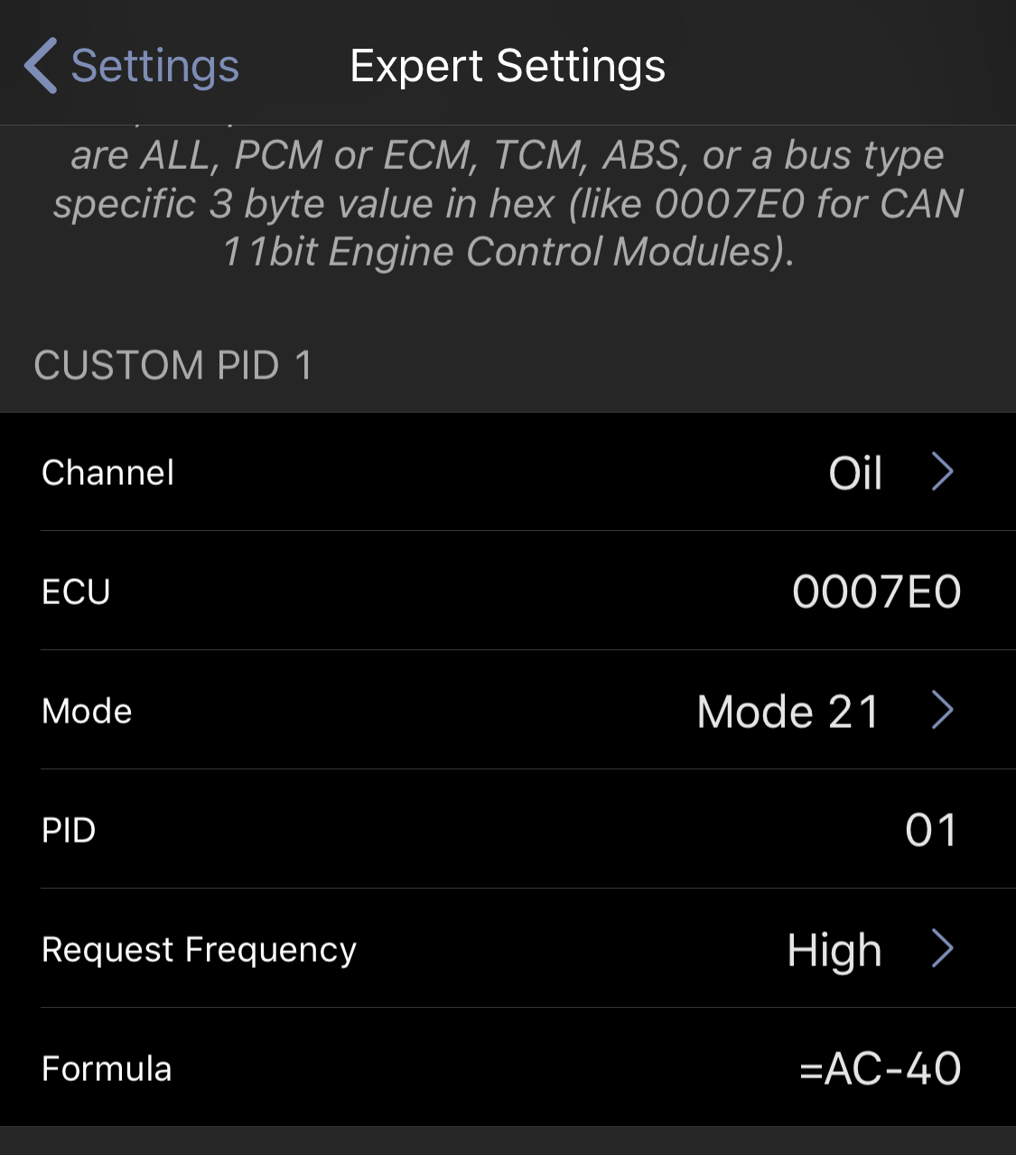

I have Harry's in Grand Prix edition, have been using it for track days and its great. Saw the new Custom PIDs support in v22. I'm using the Kiwi 3 OBD bluetooth.
I set up the custom PID for the oil temp as below:
When I go to Sensor List > Kiwi for Sensor Information, it does show in one of the items - 0x210 0x01 EOT
This seems to be a good sign, as I've played around with the Mode and PID, and other settings I don't get this in the Sensor Information.
However - I'm still not getting any data for Oil Temp in the app.
Any tips on the PID settings, or other Expert settings?
You did everything correct, but LapTimer didn't. I just tested your scenario and found there is an issue with expression parameters > H. This means AC in the "=AC-40" formula doesn't work for v22.1.3.
I will add a fix for the next bug fix release v22.1.4, but want to ask for some help to make sure it will really work for this release:
Please follow instructions in viewtopic.php?f=39&t=1500 to create a log of the OBD dialog with your car and send it to me. Please configure the above custom PID after you have installed Harry's GPS/OBD Buddy, start logging with "OBD Troubleshooting" enabled. Connect your Kiwi to the car and record a minute with the engine running.
The log will help me to see the precise communication and reply from your car in particular. I will use this to retest the fix I have done do far. Thanks a lot.

Hmm I copied it just like this and I still isnt working.
