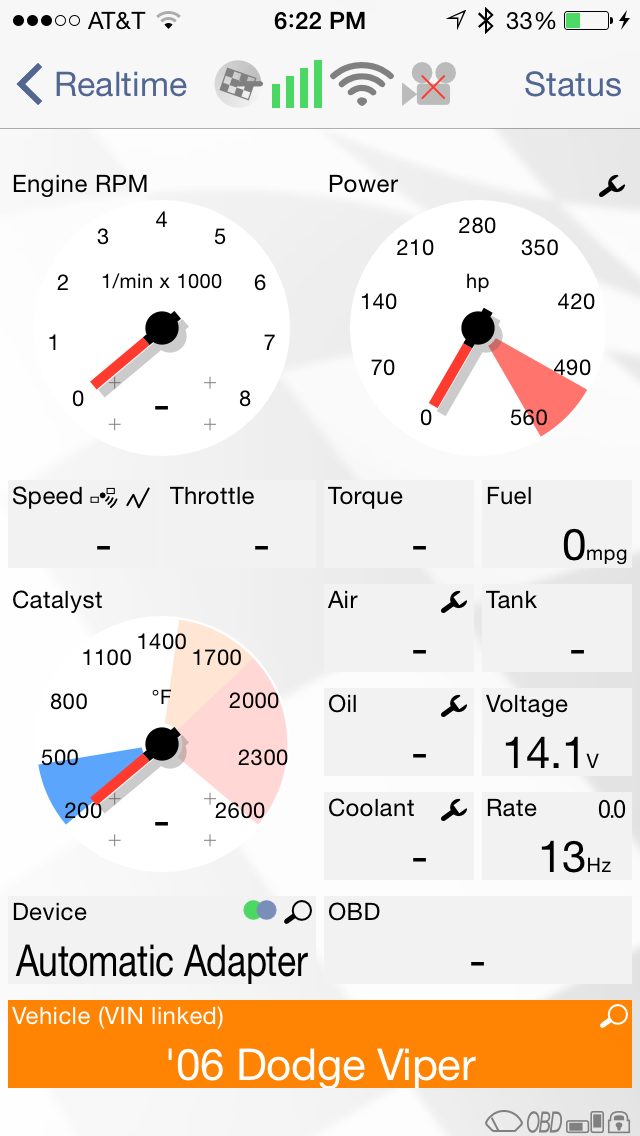

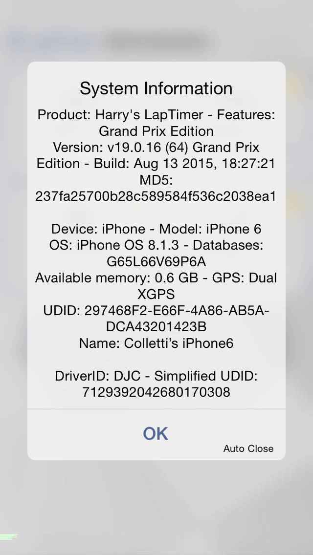

I changed my settings to:
Non CAN bus vehicles:
LapTimer ‣ Administration ‣ Settings ‣ Expert Settings ‣ OBD Tweaks / Sequential Requests (BT1) ‣ ON
LapTimer ‣ Administration ‣ Settings ‣ Expert Settings ‣ OBD Tweaks / CAN Multi Requests (ELM327) ‣ OFF
I have v16 installed.
There is still no data being shown.

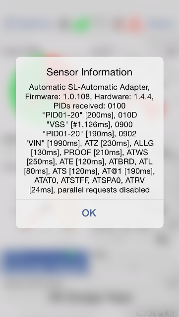

Please post your Sensor Information after disabling CAN Multi Requests.
I have tested the settings with the latest LapTimer and Automatic versions and it doesn't send multi request any more (as expected).

I'm still not getting the data.
I followed the directions to send you a data trace.
Please let me know.
