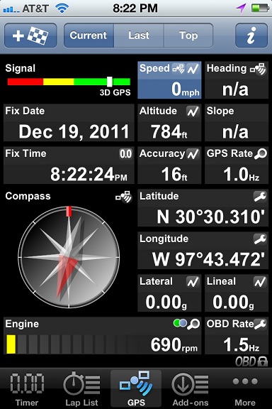

2003 Porsche C4S, seeing 1.5-1.6Hz with KiwiWifi on a Iphone 4s.
I wish it was faster but I guess for the price I couldn't be happier. Can't wait to get to the track with this setup!
- photo (1).jpg (86.04 KiB) Viewed 16826 times
