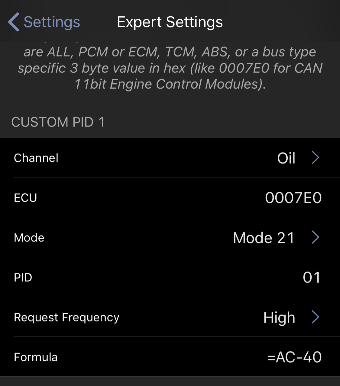

I have Harry's in Grand Prix edition, have been using it for track days and its great. Saw the new Custom PIDs support in v22. I'm using the Kiwi 3 OBD bluetooth.
I set up the custom PID for the oil temp as below:
When I go to Sensor List > Kiwi for Sensor Information, it does show in one of the items - 0x210 0x01 EOT
This seems to be a good sign, as I've played around with the Mode and PID, and other settings I don't get this in the Sensor Information.
However - I'm still not getting any data for Oil Temp in the app.
Any tips on the PID settings, or other Expert settings?
Posted: Sun Nov 25, 2018 1:40 pm
You did everything correct, but LapTimer didn't. I just tested your scenario and found there is an issue with expression parameters > H. This means AC in the "=AC-40" formula doesn't work for v22.1.3.
I will add a fix for the next bug fix release v22.1.4, but want to ask for some help to make sure it will really work for this release:
Please follow instructions in viewtopic.php?f=39&t=1500 to create a log of the OBD dialog with your car and send it to me. Please configure the above custom PID after you have installed Harry's GPS/OBD Buddy, start logging with "OBD Troubleshooting" enabled. Connect your Kiwi to the car and record a minute with the engine running.
The log will help me to see the precise communication and reply from your car in particular. I will use this to retest the fix I have done do far. Thanks a lot.

Posted: Mon Jan 14, 2019 4:22 am

I just upgraded my ECU tuning software to ecutek racerom 10 from the previous version and now my oil temp won't show up. Any help?

nogzie wrote: Sun Nov 25, 2018 12:19 am I have Harry's in Grand Prix edition, have been using it for track days and its great. Saw the new Custom PIDs support in v22. I'm using the Kiwi 3 OBD bluetooth.
Are those zeros or the letter o in the ECU ?
Posted: Mon Jan 21, 2019 8:42 am
Zeros
Posted: Fri Jan 25, 2019 4:16 am
by 86_it_brz
Hmm I copied it just like this and I still isnt working.
