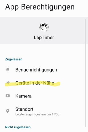

Please check:
Android Settings ‣ Apps ‣ LapTimer ‣ Permissions ‣ three dots in the top right ‣ All permissions ‣ Nearby devices
What do you see here, are "connect to paired BT devices" and "discover and pair nearby BT devices" listed? Going back one level, is the permission "Nearby devices permission" set to "Allow"?
Re: Android 13 issues? Upgrade to GP edition and external BT connections
Posted: Wed Apr 05, 2023 12:04 pm
by Sideshow
Harry wrote: Wed Apr 05, 2023 11:55 am Please check:
Yes, this permission was always given. For testing I anyway allowed once all permissions, but made no difference.
HLT bluetooth issue v3.jpg (21.95 KiB) Viewed 6364 times
