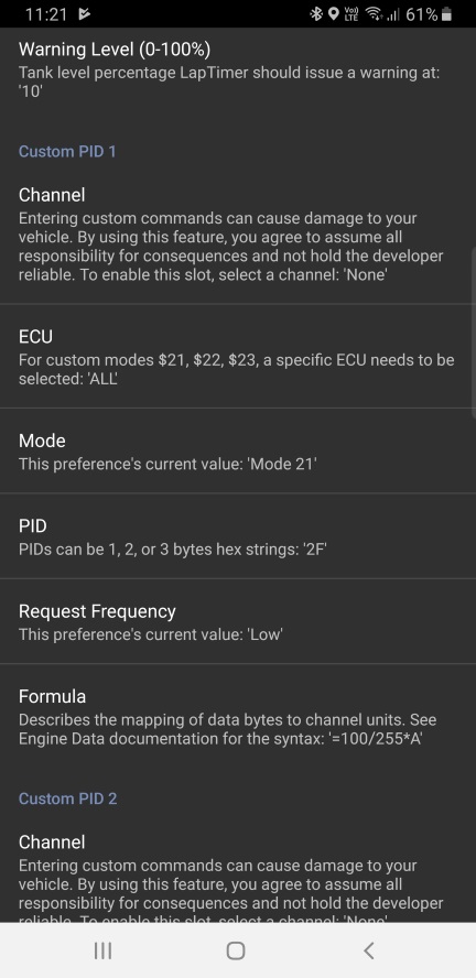

thanks, and what about syntax of formula in HLT? for example for fuel imput is it 100/255A (see on picture). So how I can set it in HLT? like =(100/255)A or just =100/255A or any else option?

Here is the full syntax for expressions in LapTimer:
Code: Select all
               formula                 =   [ "=" ] conditionalexpression
               conditionalexpression   =   equalityexpression { "?" equalityexpression ":" equalityexpression }
               equalityexpression      =   relationalexpression { "=="|"!=" relationalexpression }
               relationalexpression    =   expression { "<"|">"|"<="|">=" expression }
               expression              =   [ "+"|"-" ] term { "+"|"-" term }
               term                    =   exponent { "*"|"/" exponent }
               exponent                =   factor { "^" factor }
               factor                  =   parameter|number|"(" conditionalexpression ")"
               integer                 =   "0"|...|"9" { "0"|...|"9" }
               number                  =   integer [ "." { "0"|...|"9" } ]
               parameter               =   "A"|...|"Z" { "A"|...|"Z" } [ bitqualifier ]
               bitqualifier            =   integer
So you better use "=100/255*A". Brackets are not required, evaluation for a <term> is left to right.

just like that? Im not sure about Mode, which I should use 21, 22 or 23
2016 SEAT Leon CUPRA 290 ST
Re: Oil Temperature OBD?
You will need an ECU selection at least. Formally that's fine otherwise, but I cannot comment on any custom PID setting for Skodas.

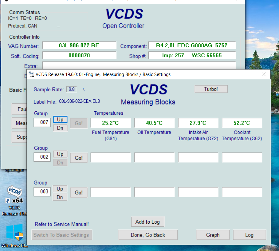

Hi Harry. I´ve tried to check oil temp via VCDS and I can see correct value. Can I use VCDS data to find optimal PID settings for HLT? Or it´s nonsense?
I have no experience or insights into the VCDS tool. Someone else to help?
