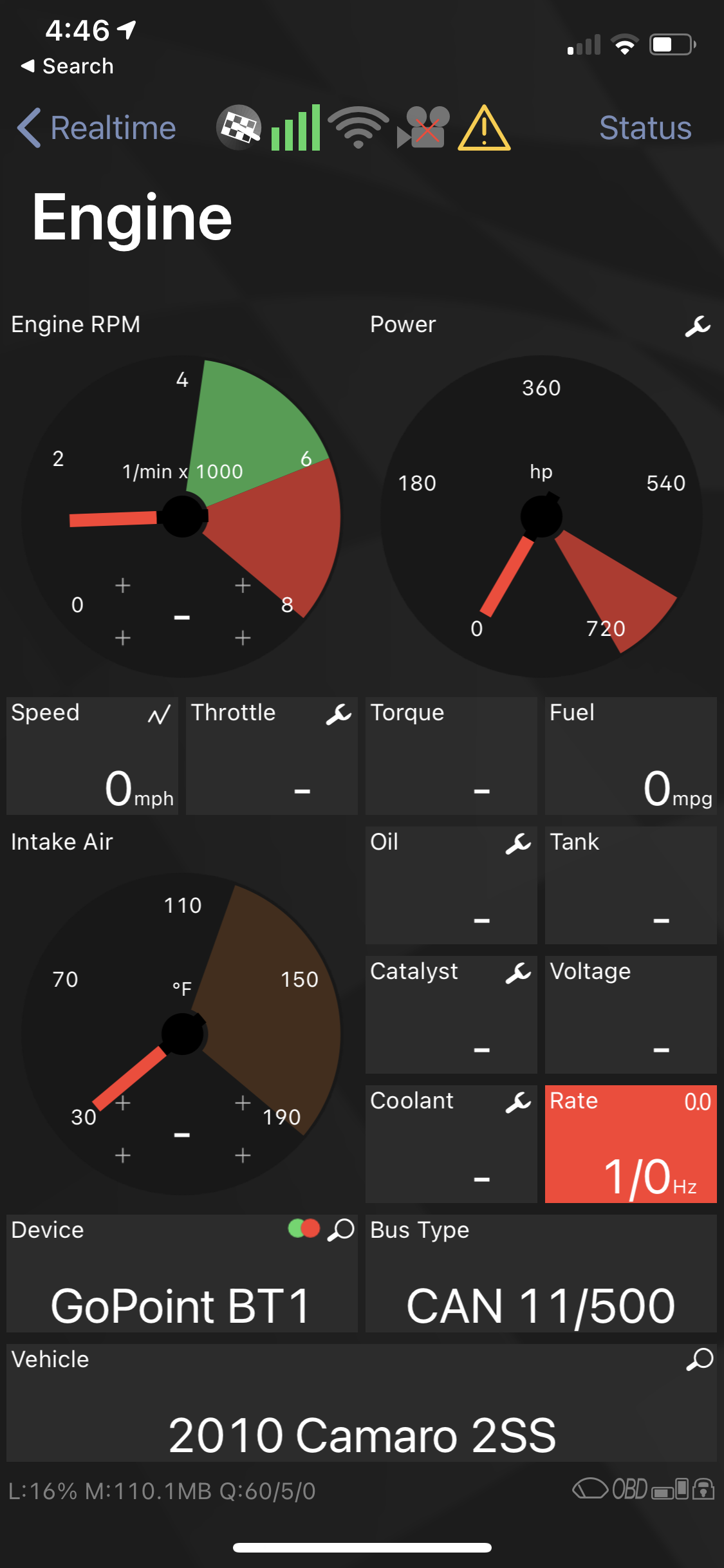

Posted: Sat Jan 16, 2021 11:09 pm
by dookie454
I've played with it quite a bit, and I can only get 1hz from the OBD data, GoPoint BT1, and really I only get RPM, nothing else.
I've tried excluding most of the PIDs on the list, changing a bunch of other settings, but still only 1hz from the OBD data, and really only RPM.
I know this worked in the past, but havent tried it in a couple years.
Also have the red dot on the GoPoint, that usually means something is wrong, correct? The GoPoint seems to work fine with DashCommand, it shows the data streaming like normal, faster rate.

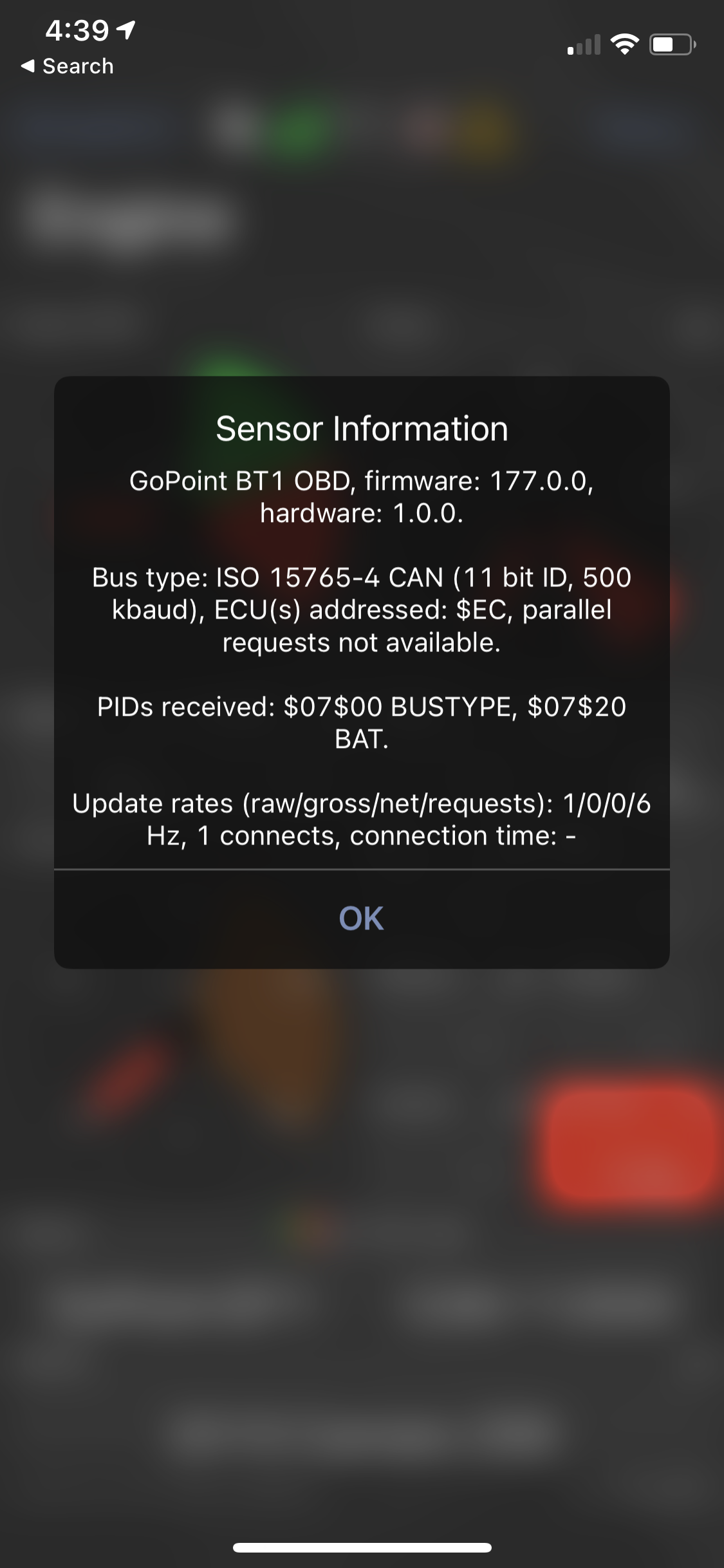

Re: OBDII Data
Posted: Sun Jan 17, 2021 10:16 am
You have changed the "ECUs Addressed" Expert Setting to something like $EC? This field should be either ALL, PCM, TCM or a valid hex address. Please set "ECUs Addressed" to "ALL" (without quotes). Goto Sensor List and press Refresh. Then connect, I'm positive it will work.
To make sure there is no issue with the ECUs Addressed parameter in general, please let me know what precisely you had in this field.

I tried the variety that I had, including 7E0 and 7DF, since those are what I use with my separate CAN OBD display device, and ended back up at ALL.
Tried ECU since that is in the help description below, and that changes itself to the $EC you mention.
Also tried the reply address I use with 20-30hz on my stand alone device and that is 7E8.
They all still show 1hz. 1/0/0/0.
I get dropouts/disconnects with ALL though, maybe one every 30 seconds or so (data goes dead, Device and Bus Type go blank). Changing to ECU ($EC) fixes that. But still, 1hz update rate.
Also, only getting RPM, nothing else is showing up with any of these ECU addresses.

Re: OBDII Data
Posted: Mon Jan 25, 2021 12:34 pm
Looking into your settings, I see a number of changes in OBD Expert Settings, the change for "ECUs Addressed" in particular.
kECUsAddressed : 'ECU', expert preference, changed from default 'ALL'
I didn't spot this in you last spots, but this one is wrong. "ECU" stands for "engine control unit". A typical modern car has several ECUs for engine, transmission, etc.
From LapTimer's Engine documentation:
By default, OBD adapters will broadcast any request to the vehicle network. It is well possible more than one ECU will deliver a result and return it to the app. A sample is shown in Full Cycle Requesting Channel RPM with 2 ECUs Answering were the engine revolutions per minute are returned by both the Engine Control Module (ECM or PCM) and the Transmission Control Module (TCM). Broadcasted requests are named “functional calls” in a bus infrastructure. While broadcasting is convenient (we do not need to know to which ECU to talk), we are mostly not interested in receiving the same piece of data multiple times.
So ALL, ECM, PCM, TCM can be used for protocol independent addressing, or a hex string to use a protocol specific header.
Not matching one of the symbolic names ("ECU" <> "ECM"), your current string "ECU" is parsed as hex "EC" shown as $"EC". The M is omitted because it is not a valid HEX character.
So please change it to ALL to verify standard operation and switch to ECM or PCM for optimization.
NB: most of recent LapTimer OBD optimizations went into the ELM protocol. GoPoint's adapters use a proprietary protocol I do not further refine. So some of the tricks listed in the engine documentation may not work for the BT1 at all.

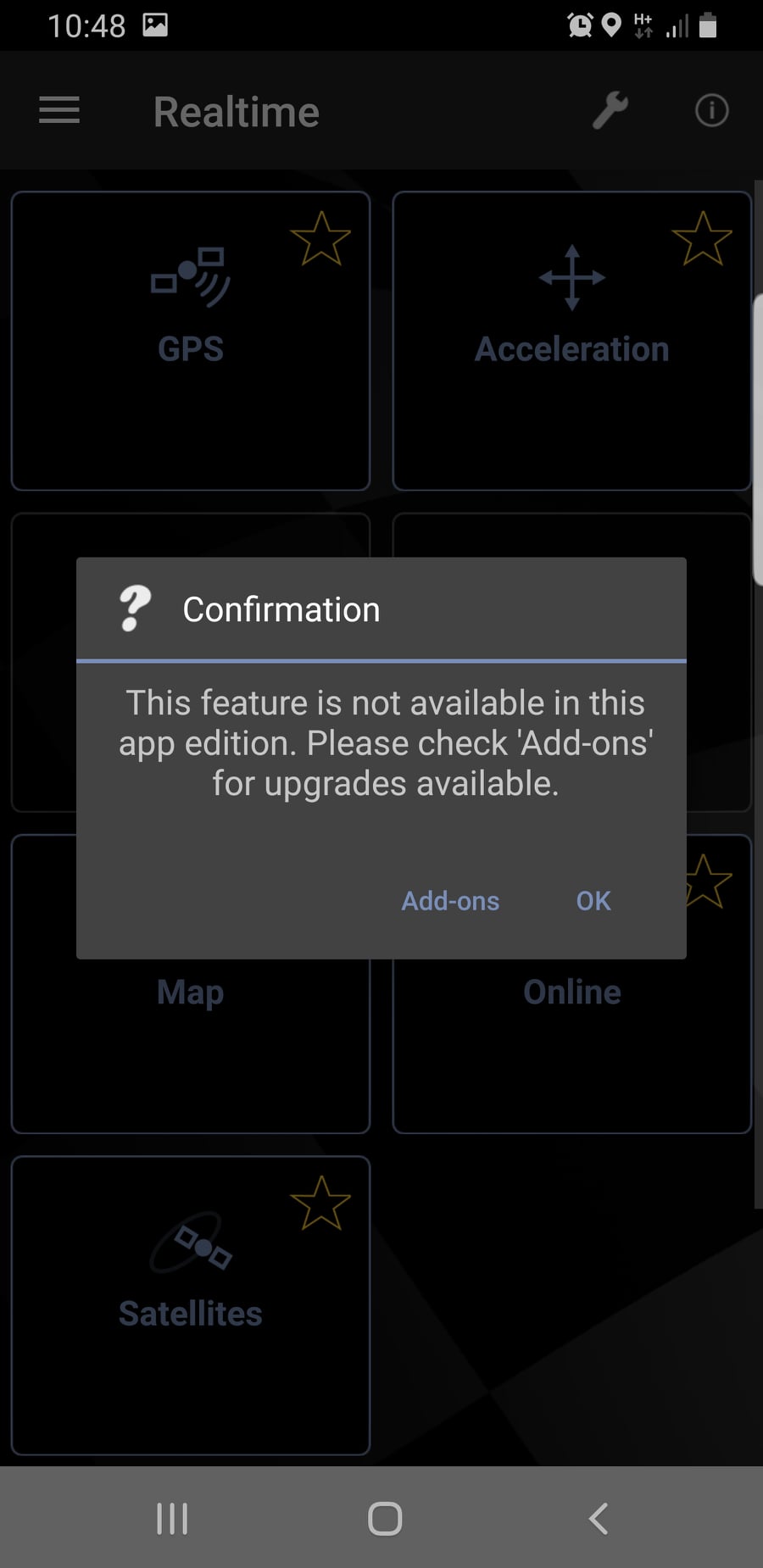

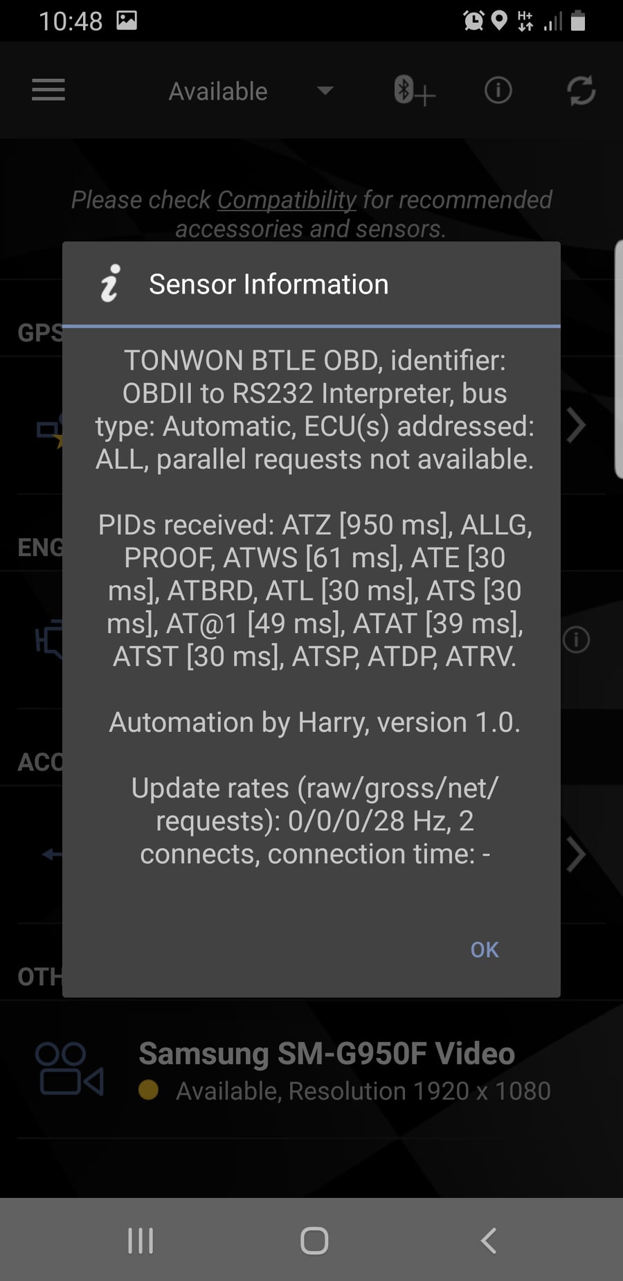

Posted: Wed Feb 03, 2021 10:13 am
by west1785
I'm trying to see real time engine data from Tonwon BTLE OBD sensor but it says it's not available in this app edition. I have Petrolhead edition v24.0.4, The engine icon (Analysis -> Realtime - Engine) is greyed out. Sensor is connected and working fine. See screenshots attached. Thanks!
