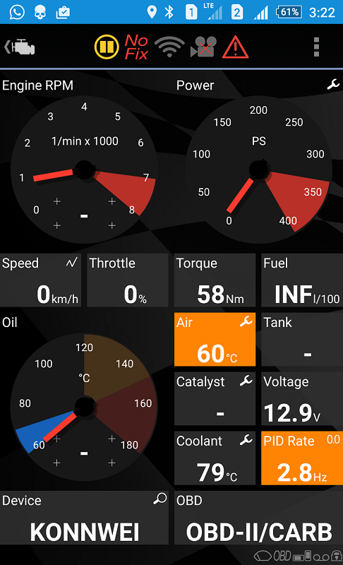

hey Harry, I have the same problem too.
I mainly have 2 problems.
1. It doesn't show the correct date like YY/MM/DD on overlaid video
2. It doesn't show the OBD2 data on overlaid video
I can see all data during recording on the screen but OBDII gadget always shows "none".
What should I check? or anything to do with the settings?
I had bought for over a year and can never get it done ... feeling sad ... T^T

- Screenshot_2016-02-26-15-22-29.png (242.57 KiB) Viewed 12338 times
- Screenshot_2016-02-26-15-22-17.png (167.87 KiB) Viewed 12338 times
- Screenshot_2016-02-26-15-13-43.png (148.33 KiB) Viewed 12338 times
Re: OBDII Data
here are another 3 screenshots
- Screenshot_2016-02-26-15-32-47.png (142.66 KiB) Viewed 12344 times
- Screenshot_2016-02-26-15-32-37.png (219.08 KiB) Viewed 12344 times
- Screenshot_2016-02-26-15-22-44.png (249.31 KiB) Viewed 12344 times
Re: OBDII Data
Yes, as discussed by mail: LapTimer will not store OBD data as long as no GPS data is available. The GPS stream defines the storage rate in LapTimer. In case it is 0, no OBD data will be stored either. Even if it is available and displayed in real time.
