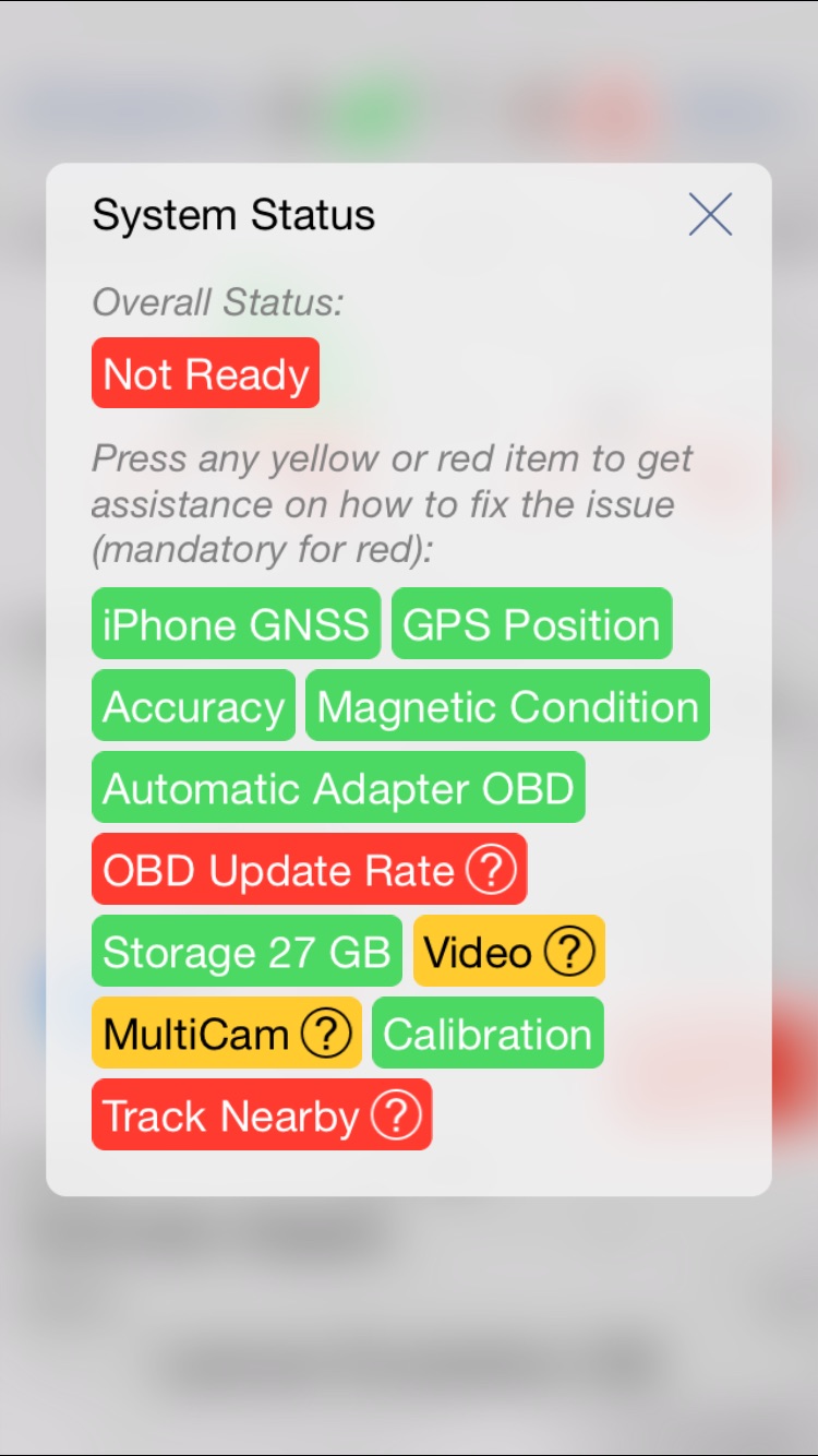

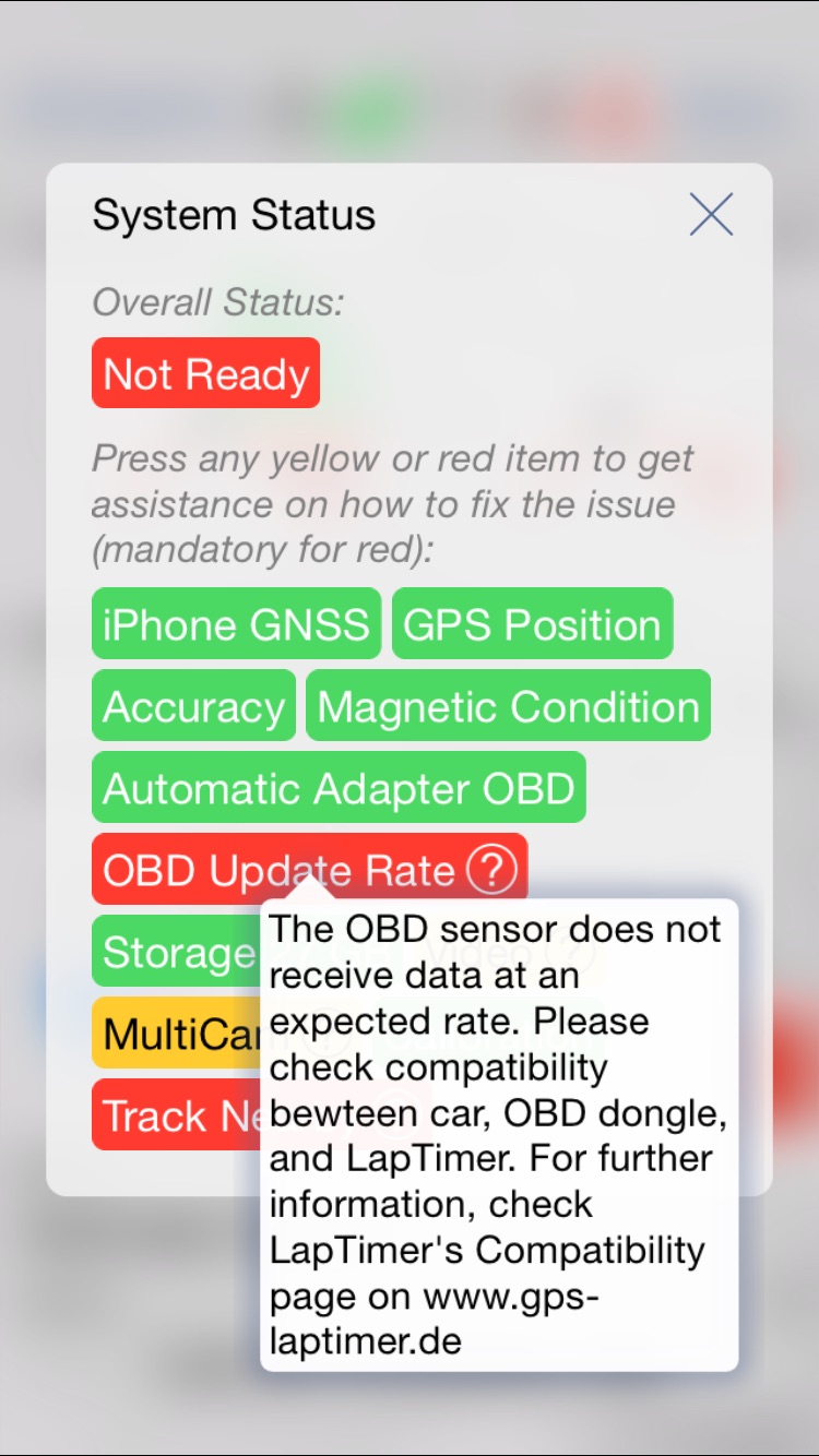

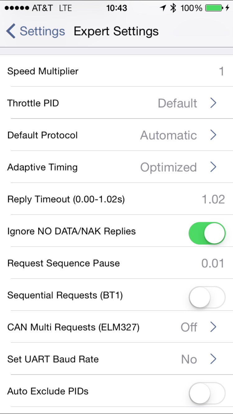

I removed all the PID exclusions, here are shots of the error message and the OBD tweaks section. Thanks for the help!
- system status
- system status.jpg (152.6 KiB) Viewed 10562 times
- system status error
- system status error.jpg (188.64 KiB) Viewed 10562 times
- obd tweaks
- obd tweaks.jpg (129.44 KiB) Viewed 10562 times

I assume the setting below "Auto Exclude PIDs" is empty too?

Correct - I authorized LapTimer once, and it has never asked again. The sensor list, info page, and everything else looks identical in the older firmware. On the sensor list, it shows "Connected" but with no frequency reading. Going to the real time page shows the same Update Rate error as before.
