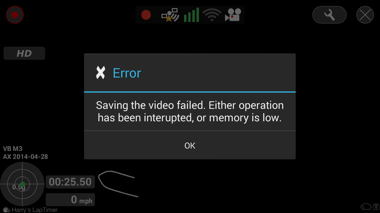

"Saving Video failed. Either operation has been interrupted, or memory is low"

Yes the video window was open. Attached a screenshot. I thought maybe it did it after sleeping the device while the video window was open but I tested that and it didn't happen again. Once it does this you have to kill lap timer in the task list and relaunch it. I am pretty sure when it failed it was after I slept the device.
Also after sleeping the device with video view up, when waking the device the video display is always black. Exit video and then go back into video fixes it. Not sure if that has anything to do with the error.
In the screenshot you can see its the video view and the video has gone black after the error.
