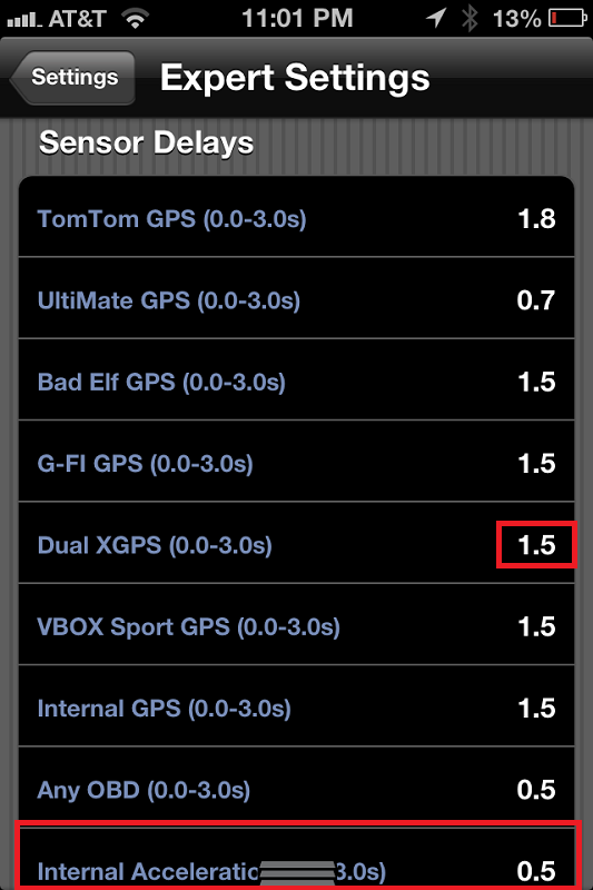

Can you take a look at this one? I am using iphone 4s with XGPS160 for boost and GoPOINT GL1 connected OBD. I ran with .5s obd delay. But if you looks closely, you'll see it's (RPM) a little slower than speedo. Should I do .4s? thanks
DATA file:
Fastest time philly scca dover 9.15.csv
(148.53 KiB) Downloaded 410 times
Setting:
harry's laptimer.png (101.74 KiB) Viewed 11059 times

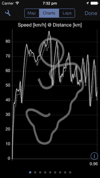

Topic #1 - sync between GPS and OBD speed
Please note all of my statements below are based on the assumption the recording you sent has been recorded using exactly the delays shown in your snapshots above!
From the first snapshot you can see GPS and OBD speed are shifted on the timeline and not in sync...

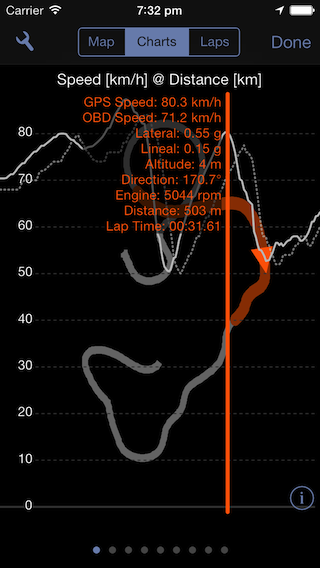

iOS Simulator Screen shot 18.09.2013 19.32.23.png (81.33 KiB) Viewed 11044 times
In Grand Prix a cursor is available to see the details, I choose one peek:
iOS Simulator Screen shot 18.09.2013 19.32.42.png (96.72 KiB) Viewed 11044 times

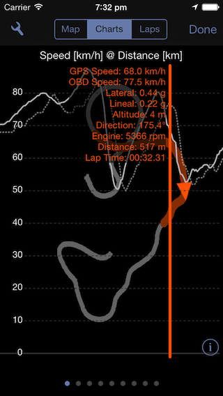

and the corresponding peek for OBD
iOS Simulator Screen shot 18.09.2013 19.32.47.png (96.35 KiB) Viewed 11044 times
Time gap is 0.7 seconds and OBD is late... This means you need to increase the OBD delay as it is obviously coming in with a bigger delay than expected (0.5s). So setting "Any OBD" to 1.2 will do the job for the next recording. As an alternative, you can decrease GPS delay - which is my recommendation as the XGPS's default is 0.7 anyway. So any OBD = 0.5s and XGPS = 1.5-0.7 = 0.8 should be fine.
