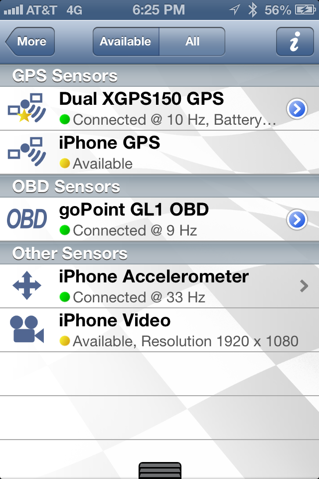

So I did get the XGPS160 and GL1 to keep the bluetooth load low. (I think you need to add the XGPS160 next update because now it's recognized as xgps150 BUT it does show 10 hz rate :D )
I tested out in various config: GPS only with GO PRO overlay. GPS + GL1 with go pro overlay. GPS + GL1 with iphone HD recording. here's my finding:

The OBD data seems to be ahead of the video and or GPS information. The GL1 is a pretty special device as due to it's cable connection it has very low latency (and pretty high update rates). When LapTimer mixes sensor data, it needs to make a guess how old the data is it receives. Any sensor has a certain delay between the real world event, and the time the corresponding data is available for LapTimer. While GPS has a pretty big lag, OBD is lower - for the GL1 in particular. LapTimer has a Expert Settings for all sensors. The standard value of 1 s is obviously too big for the GL1. So please try reducing it to 0.5 and go through a recording / overlay cycle again (delays are applied to new recordings only, not to existing data).
There is a similar thing for sensor data to video data delays. The video sensor has a delay too and can be adjusted (in RR you do this manually for each overlay). Please once you have OBD and GPS well synchronized, please check the sensor / video alignment. It can be adjusted using another Expert Setting named "Overlay Synchronization". In case sensors are ahead of video / audio, increase the video overlay sync value. Once this has been done once for your BT1 / GL1 / LT video combination, it will be fine forever :-)
