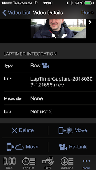

Re: Video download
The Move button appears for videos that can be copied only. So if you select a video from the "Camera Roll" section (these are the videos sitting in the Photo App), there will be no Move button. In case you select a video from "LapTimer Recordings" you should see the Move button like in the snapshot below.
- IMG_3105.PNG (107.75 KiB) Viewed 2617 times
