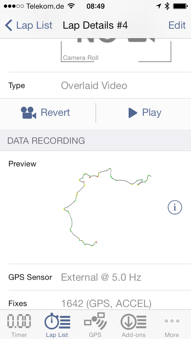

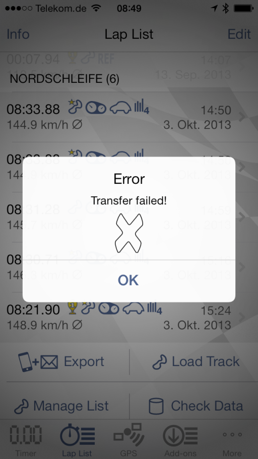

unfortunately I'm experiencing problems in tranferring single laps or entire track days btw different devices.
An error message on the receiving device appears "Transfer failed" and the lap (see data recording pic) is only transferred partly.
On the sending device no message appeared.
I tried transferring from iPhone to iPhone as well as iPhone to iPad. In the iPhone to iPhone case I'm sure we used the identical version of laptimer (17.4.3).
Thanks in advance

The pic where you see the track layout recorded has nothing to do with what has been transfered. It shows you what Laptimer recorded while lapping, so in your case it really seems as if the recording was interrupted while lapping and the data might be corrupt and that's why it's failing (probably at least). When you try to transfer the whole day, is this corrupt lap also part of the set?RaftRacing wrote:Hi Harry,

It seems the device to device communication is somewhat broken in iOS7... I have been able to reproduce the failing transfer (sending from an iOS6 device and receiving on an iOS7 device). The sender side sends 14 data packages in a row, but only 10 packages arrive on the receiver side. When LapTimer imports this incomplete file, it finds an unexpected and of file and issues the error message. All data up to package 10 is added to the database. I will try to find a workaround and search the developer forums. Worst case is we need to wait for an iOS7 update here. As a workaround, you may export your laps to a mail file and send it to an account on the other other phone currently.

The file Christian provided includes the full lap (a pretty fast one by the way), the above picture is indeed the incomplete transfer.bulls23 wrote:The pic where you see the track layout recorded has nothing to do with what has been transfered. It shows you what Laptimer recorded while lapping, so in your case it really seems as if the recording was interrupted while lapping and the data might be corrupt and that's why it's failing (probably at least). When you try to transfer the whole day, is this corrupt lap also part of the set?RaftRacing wrote:Hi Harry,

Found a workaround already. The above issue is not exactly an iOS7 bug but simply a "different behavior" by the OS. I will add the workaround to LapTimer v17.5
