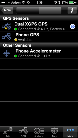

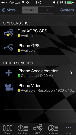

I just purchased a Dual XPS150A and upgraded it to the 1.2.3 firmware version from Dual. While LapTimer sees this device as available, it never actually connects and gets a fix.

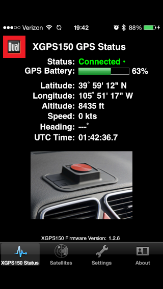

What's really interesting is that Harry's GPS Buddy can find a fix on the same device, as well as Dual's own app.
I've tried a few things, including killing all GPS apps, removing the device from Bluetooth, rebooting, adding the device back in, and starting LapTimer - no difference.
This is the GA version of iOS 7.0 on an iPhone 5.
I can also get LapTimer to crash if I click on the magnifiying class on the Signal section of the GPS page. I'll send in a crash dump for that issue.
Any ideas?

- IMG_4728.png (95.11 KiB) Viewed 8760 times
- IMG_4726.png (43.22 KiB) Viewed 8760 times
- IMG_4727.png (81.91 KiB) Viewed 8760 times
