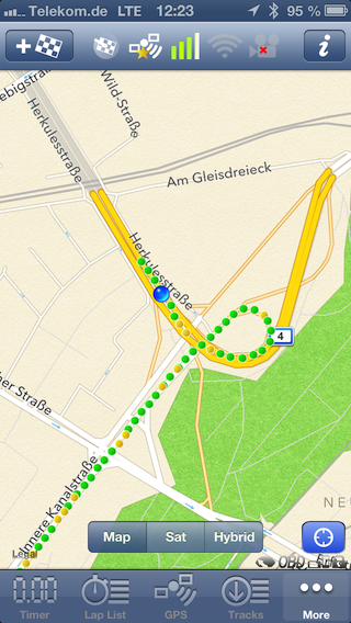

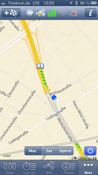

Some new insights into the way the Map view uses location services:
In both snapshots I drive from South to North - that is the main direction. Actually both snapshots are taken with only a few seconds in between. The first one - entering the highway - leads into a tunnel I leave on the seconds snapshot. So far only to understand the scenario - the tunnel is not important for the rest of the mail.
The very interesting thing is the dots are ahead(!) of the current position shown! This effect became stronger when driving faster. This obviously means both positions come from a different source - the dots are added by LapTimer using the VBOX positions delivered directly, and the blue position is delivered by the internal sensor / location service! Initially I expected that both LapTimer's direct access and iOS's location service access the VBOX position... But thinking a bit about it from a technical side should make clear that is not possible. Why? When the VBOX is connected to the iPhone without an app like LapTimer accessing the data directly, its data is integrated into iOS's location service. This means the internal sensor is turned off and the VBOX data is feed into any app requesting positions. The update rate one can achieve is 10 Hz here - more is not possible as the BT bandwidth is used up utilizing Apple's integration lingo. The 20 Hz delivered by the VBOX are only accessible when using LapTimer's special integration based on RL's proprietary and compressed protocol. As the Map is not aware of LapTimer's position knowledge, it requests positions from Location Service. Given the bandwidth discussion, it would certainly not be possible to integrate the Location Service with the VBOX using the 10 Hz update rate and LapTimer's 20 Hz integration at the same time. So my assumption is the RL engineers did the following:
Quite an expert thread...
- The VBOX Sport usually integrates into iOS's Location Service. So when any app requests position information through Location Service, it enabled the Made for iPhone integration and delivers VBOX positions at 10 Hz. The internal GPS is turned off.
- Once an app accesses the VBOX directly, it disconnects from Location Service to have the full bandwidth available for the direct integration (delivering 20 Hz). As LapTimer does not access the Location Service while the VBOX is connected, the Location Service is not active.
- But there is a special refinement of item #2: when switching to the Map view in LapTimer, things change. The map objects accesses Location Service - not LapTimer's position information. This means Location Service turns on (the small arrow appears in the status bar) - and used the internal sensor (because the VBOX has made itself unavailable).
