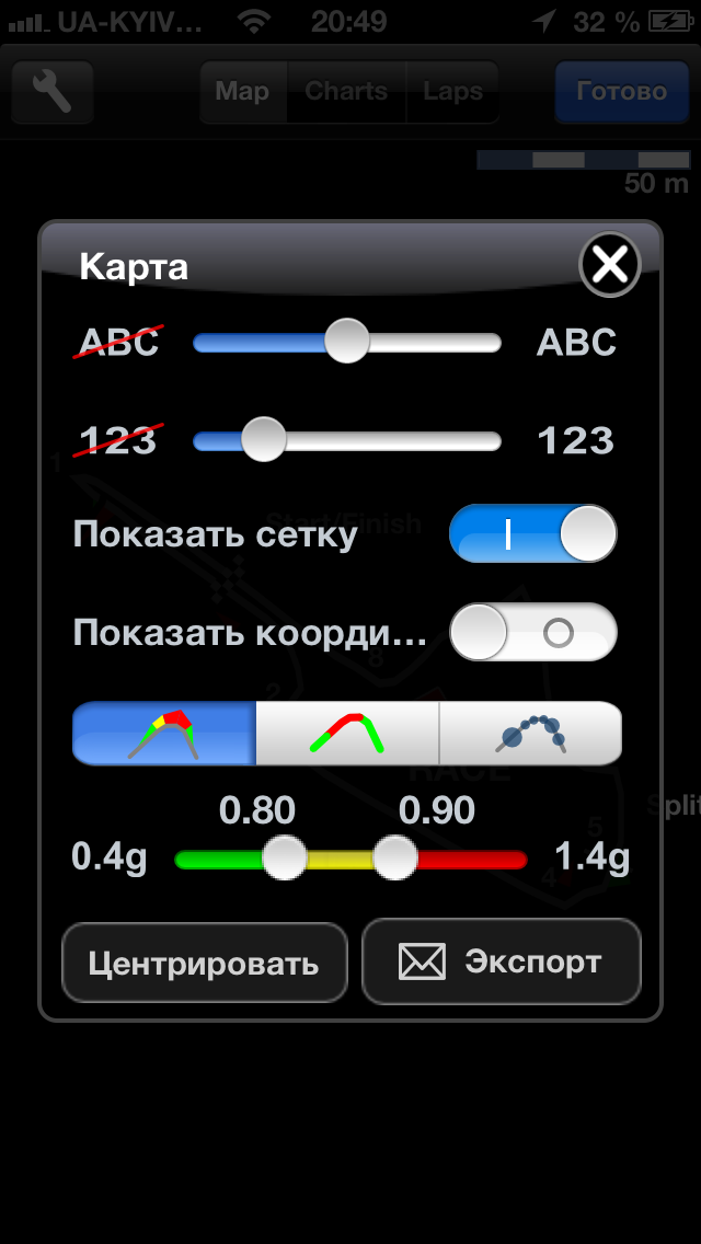

Harry, many thanks for your reply, at the "map view" there are 3 options: lateral/linear accelerations & GPS fix, could you possibly add 4th option such as time between each turn/sector please?
That would be very much appreciated :)
I found the "Laps" view, but its not very user friendly :roll: , hard to understand which sector? and where exactly? Its just colourful bars which tell me nothing at all :?

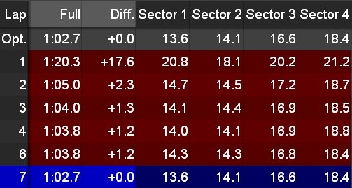

The Laps chart has far more data available than any of the snapshots shown. Please understand I cannot double functionality just to offer a different style - this may please some users, and add complexity to all others. In case the Laps view is difficult to understand, please let us discuss what exactly cannot be understood and needs better visualization or explanation. As written above, the Laps view shows a selection of lap side by side. Blue means the respective sector has been an improvement when driven, red sectors mean best sector ever. In the example above, the 8:15 has actually been a very good lap as it improved all sectors but the fifth. In case you want to see an individual sector, select the tool button in Laps and select any sector using the top most button in the configuration view coming up.
P.S. In case you want a table view like that shown, please export your laps to .csv and import them into Excel.

Just building on this, I've seen other acquisition data that has a matrix or table which reads each turn of the course (columns) and each lap of your session (rows). And then each row shows the delta +/- in seconds relative to your best lap for each turn. Then you can see although lap 5 was fastest, it was lap 3 where you took turn 2 the fastest. Also where your fastest lap is the baseline for all your deltas, it would also show your "optimal" lap, ie if you pieced together your fastest turn or sector of each lap, your optimal theoretical best lap would be x:xx:xx.
Re: Sector Times
The side by side lap / sector comparison is included in LapTimer already. A fastest virtual lap calculation is part of this display too. The Laps chart is included in Petrolhead and GrandPrix. Laps can be selected by session, car, etc. both lap and sector times can be displayed.
In the upcoming LapTimer version 17.5 I have included sector to sector change times (faster / slower) following the suggestion above. This should actually be exactly the table seen elsewhere. Virtual best calculation is improved too and will be less fragile in case not all laps show the same number of sectors.
