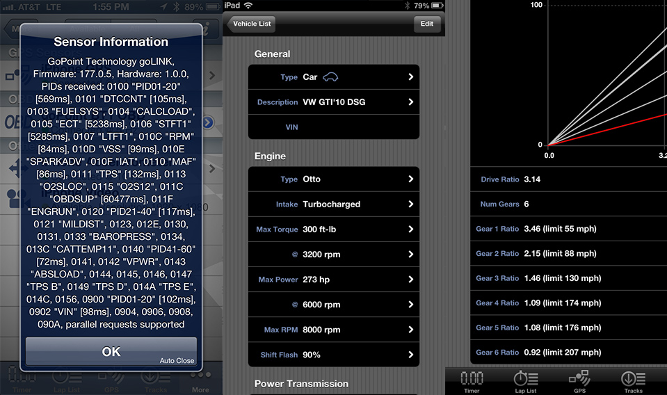

Turbo boost not showing in overlay using GoPoint BT1. 2010 VW GTI DSG with APR Stage 2 ECU.
I've tried Auto Exclude Off and it didn't make a difference when trying to view video while driving. The turbo needle didn't move. I did read that Excluding 0101 might be a work around, but if I do this do I also need to remove the "turbo" setting in Vehicle List and selecting Naturally Aspirated?
Reference video (probably won't help, but it can't hurt):
http://youtu.be/BUn-t2P0hoQ
Side note:
When viewing GoPoint info. using GoPoint "Quick Scan" iPhone App the RPMs register correctly, but during my track day (see view above) the max RPM registers a 6k when I clearly saw my tachometer hit 7k. Maybe I'm not entering my Vehicle information correctly. I've moved the RPMs around trying to test it so it might be way off by now. Tuning information if that might help: http://www.goapr.com/products/ecu_upgra ... trans.html By using the information supplied by APR there is no no green area of the tach. overlay which doesn't look right to me.
