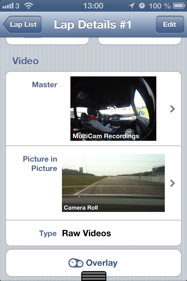

I do not think the two cases covers my situation as it says "Camera Roll" in the "Source" section of file properties. For further details see attached screenshots. If the video is not GoPro or Multicam, what should it say in the metadata? The Multicam video has Genre data: "multicam://cloud/JIH-DE35FFCD-00".

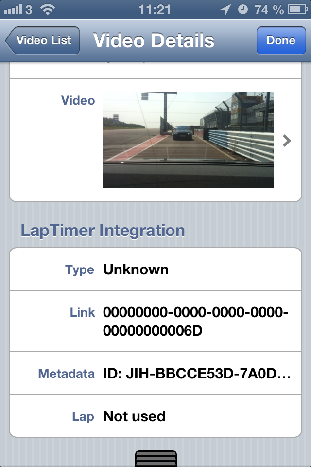

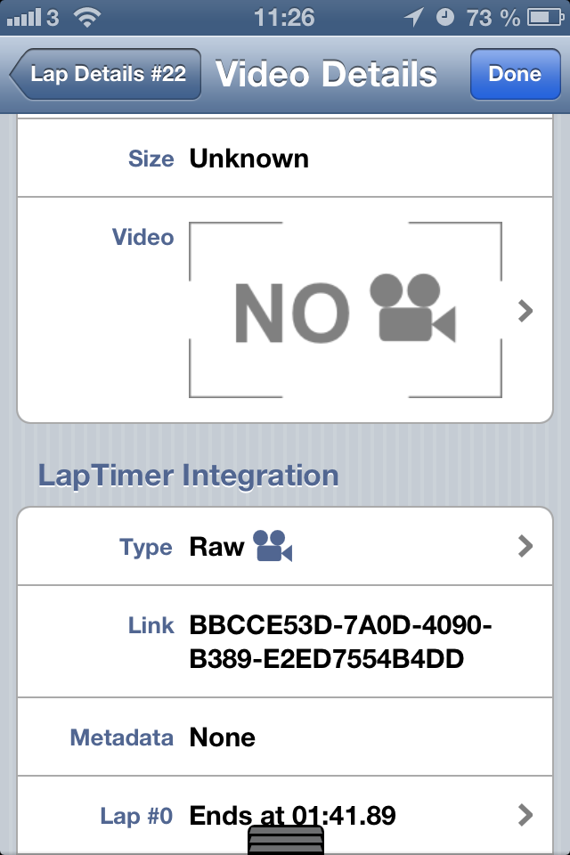

This is the link I see in HLT for the video that does not get recognized. It also says Metadata None when I check in the lap details for the video. But if I go the Video list and details for this video it says a different link and Metadata as I input with MetaX. See screenshots from lap details and Video list details.

The snapshots are as follows: 1) The lap has a "hard" link (BBCC...) to a video sitting in the Photo library. The metadata field would show values in case the above hard link could be resolved - which is not the case. 2) The video stored in Photo library manually (0000...) has a metadata information JIH... (which actually should be JIH-BBCCE53D-00). Problem is the hard link in the first snapshot, the video is not referenced by a MultiCam tag (soft link) any more...
To finally solve the situation, please proceed like this: write down the sync time "01:41.89" from the open video link in the first snapshot. Return to Lap Details and remove the open video link (e.g. by swiping the video row). Press "Add Video" and select the "0000..." video from the Photo library. LapTimer will prompt you to define the sync point. Adjust the selection to show "01:41.89" and close the view.
