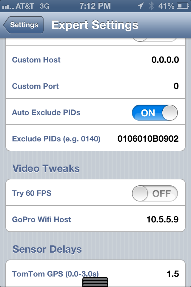

I have my new BT1 device and set up the screen on Harry's Lap Timer as you said. The device has been plugged into my OBDII port on my S54 M3. Regrettably, the device is not recognized by my phone bluetooth. I haven't tried it on my MB to verify the device but it does not link in my bluetooth nor when I open the BT1 program. Here are my settings in Harry's Lap Timer.
Apple Screen.png (85.03 KiB) Viewed 5779 times
Help anyone? I would really like to get this to work!!!
Re: BMW vrs GoPoint BT1
In case you cannot connect on BT level (i.e. see the device in iOS ‣ Settings ‣ Bluetooth ‣ Devices, and pair it successfully), no app will be able to access it. For the GoPoint BT1 no OBD settings is required, it is all prepared to connect automatically (when connected on BT level - see above).
Sorry to say but it seems there is either a second problem with the BT dongle, or an issue with your iPhone? Please contact GoPoint's support and let me know if you can't work it out.
