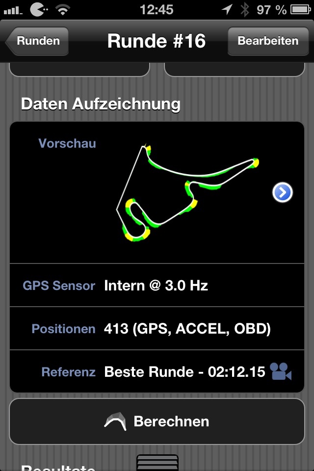

i tested the spoken lap times on my last track day. worked fine for the first laps but the delay of the anouncements increased every lap.
in the first laps the lap times were spoken directly after start/finish but in the last laps the times were spoken at the second corner.
checking the recording i realized that first accelaration is missing, in the last laps even obd and gps is missing.
i attached a screen shot from my last lap.
i am using an iphone 4s, iOS 6.1.2 jailbroken, Qstarz 818xt and GoPoint BT-1.
could this be a problem with my hardware or does anyone experience similar problem with spoken lap times?
Re: Spoken Split and Lap Deltas
Speech is generated once the lap finished is written to storage completely. So the reason for delayed speech is most probably due to longer write transactions. The rest of you issue is most probably not related to speech but about any kind of connection issue with your GPS.

I thought this could be a problem with speech because all data (gps, acceleration and obd) comes back when the lap time is spoken.
As long writing is done there is no data recorded.
Here is an overlay of my last lap. Data is missing between start/finish an second corner. You can hear the speech in the recording.
Earlier laps are similar - But the delay is not that long (only first corner is missing).
I'd suggest you try the same scenario using the internal sensor the next time. It is pretty difficult for me to troubleshoot the QStarz / Jailbreak / roqyBT configuration. From what I see from the video, the lap start has been triggered correctly, but no data arrived / has been stored. At least for the GPS part, LapTimer will store this data even if the previous lap's save transaction is not yet finished. OBD fixes are indeed dropped in case LapTimer is busy writing.
One more approach: please turn off speech output too. I'd like to understand if the two topics are related at all.
