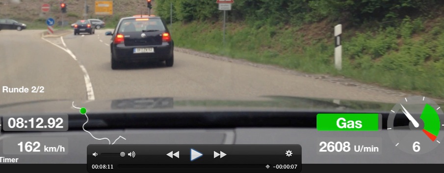

I am using the petrolhead version and have received yesterday my GoPoint BT1 and suffer similar problems. But there is no constant factor which would solve the issue.
At the beginning of the overlay video the speed seems far to low (eg. 13km/h where I went at least at 60 km/h) and towards the end it the video shows more than 150km/h in a curve where you can barely go with more than 70 km/h.
Revolutions are also showing far (eg. starting with 31 rpm!!!).
During my ride i also noticed that it did not recognize the 4th gear. It went always directly from 3 to 5 or vice-versa, not showing ever 4.
As I am new to this I have not changed/adjusted anything so far.
The car i used the stuff with is a BMW 525xd automatic, current version (1/2012). I drove the car changing gears manually.
I had connected the Dual XGPS150A via BT as well.
I expressively bought it because I had heard that it is more accurate than the iPhone internalGPS signal. And now I am learning that the OBD data overwrites the GPS speed anyway?
Any help and advice is very welcome.
Thanks a lot
Frank
PS: see 2 screenshots attached
Re: OBD data corrupting GPS speedo ?
You need to configure the gear ratios for your BMW to get reasonable gear displays.
I'd assume there is a problem with the BT1 connection that generates these speed effects. I have seen quite some problems with BMWs - see some recent threads here on the forum, maybe you do not get a constant stream of OBD data at all? Can you please check the OBD update rate and let me know? They are visible in the Sensor List.
Btw, LapTimer keeps both GPS and OBD speeds, but it displays OBD in the video if available.
In case OBD data is too bad for a recording, you can turn off OBD in the dialog presented to you when starting the overlay.
Post by Frank997 »
thank you so far.
When i entered some data of my car ithe autocompleted the gear ratios itself (ehich i was thnkful about).
Regarding the speed:
During the ride it showed the right speed, it's only the video overlay which shows stupid speeds and motor revolutions... So if the OBD sent the right data during the ride it's unlikely that the data range is wrong, is it?
Thanks for thinking about alternative reasons.
Another issue: Since i successfully connected GPS and OBD with my iphone 5 the BT connection between it and my car (built-in hands-free) does not work anymore. Both devices (iphone and car) shows the other devicd in the display but does not see each other ehen trying to pair them.
Regards
Frank
Well, BT1 + XGPS150 + hands free is probably a little too complex (although it should work). Not sure someone can comment on issues here as there are probably make / device specific incompatibilities. On the speed issue: in case the data has been fine in real time, video and data recording are most probably not aligned correctly. Usually this is done automatically, but once you start moving / re-assigning videos, it may get out of sync. To check the sync, please navigate to the lap you overlaid and revert to the original video first (Revert button in English, "Original" in German). Press Edit (important) to get the lap into edit mode. Select the video. You will be presented with a Video Synchronization screen. Make sure the frame you see is exactly the END for the lap's recording, Set and overlay again. http://www.gps-laptimer.com/LapTimerDoc ... hapter.pdf has the full story on video alignment.

Posts: 11
Joined: Fri May 17, 2013 4:30 pm
Post by Frank997 »
the problem is not really to connect all at the same time but even when trying to connect the iphone again with the BMW's integrated handsfree AFTER finishing Laptimer and without comnectimg GPS and OBD.
Regarding speed and reolutions it's unlikely that the problem is caused by wron synchronisation as the revoutions (31 rpm) do not make any sense at any time.
I will do some further testing over the weekend.
