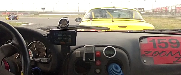

I was using laptimer last weekend at a download and Harry approved track, and had issues getting the predective laptimer to work.
iPod MC544LL, iOS 5.1.1
HLT v16.6.2 Pro
Timer, Landscape mode
jailbroke with RoqyBT4 to recieve QStarz X818 at 10Hz.
After watching my video, I can see the predictive function (lap and sector, on the two right hand ) would work on the first two laps of the session, but on every lap there after, would just count down a negative lap until start finish.
In the picture, 43 is elapsed time, and 1:18 is left, but the predictive says -1:18, not something like ~0:02, as these laps were very consistant.

Yes, I know you well :-) You are right, that is a known bug in LT 16.x. It will be fixed in version 17 which should be available within a few days.
