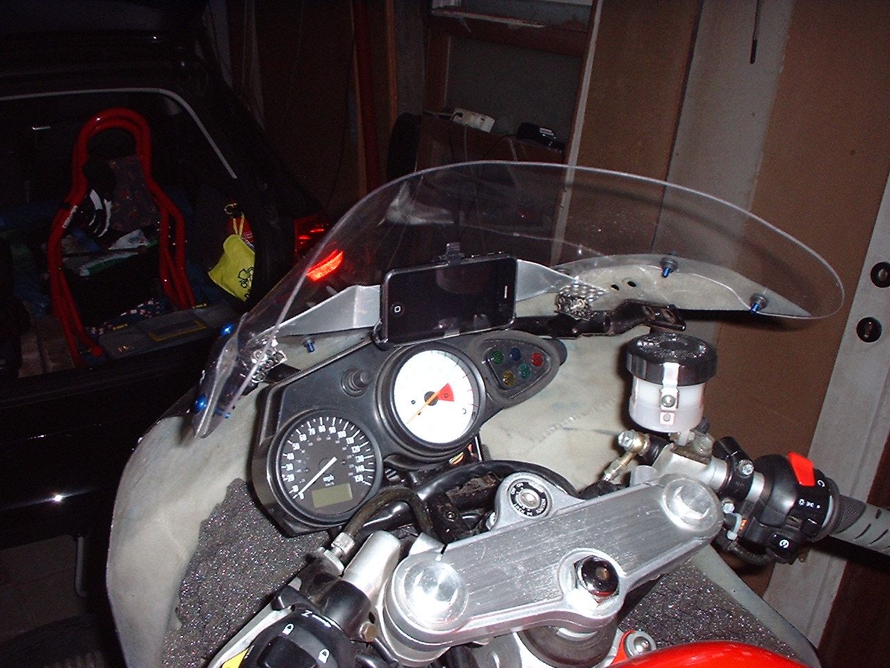

The iPhone is mounted behind the windscreen, horizontal, for filming.

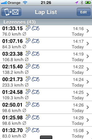

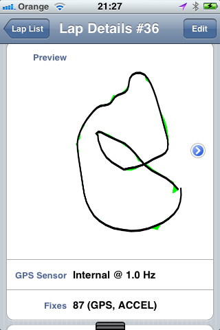

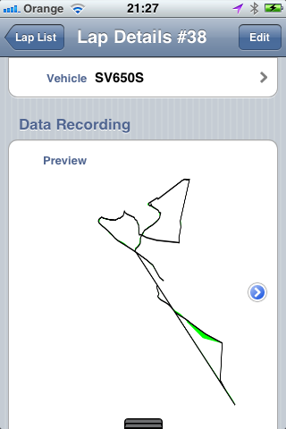

some screenshots to illustrate
first session, and lap details, to illustrate

my laptimes on this configuration at the track average around 1:24 (first laps are warmup off course)

- gps fixes all over the place, third lap in the list
- IMG_1246.PNG (35.06 KiB) Viewed 9816 times
- a pretty decent lap representation - 1st lap in the list
- IMG_1245.PNG (38.46 KiB) Viewed 9816 times
- session 1
- IMG_1244.PNG (71.28 KiB) Viewed 9816 times

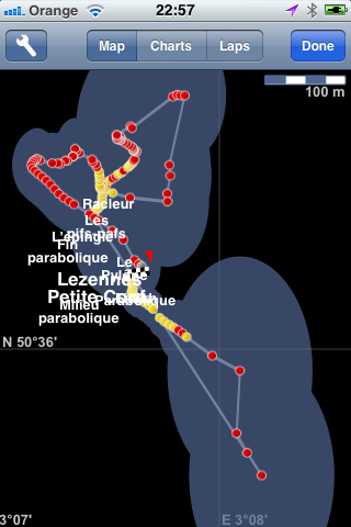

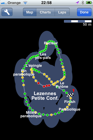

Please follow the Preview row (press); press the small wrench in the top left; select the accuracy view (blue circles. Please post a snapshot here. Thanks.

Just like would be expected from the results - the first lap has decent gps fixes, that third lap is somewhere in China, according to the gps fixes
- IMG_1251.PNG (62.88 KiB) Viewed 9816 times
- IMG_1250.PNG (58.25 KiB) Viewed 9816 times

Yes, the GPS positions are pretty inaccurate. A well positioned iPhone3G / 3GS should typically deliver 75% green and 25% yellow fixes - no red ones. The iPhone4s will be green all over the place. The only thing I can recommend here is playing with the mounting position. There seem to be some windscreen coatings including metal, maybe that's the case for you?
