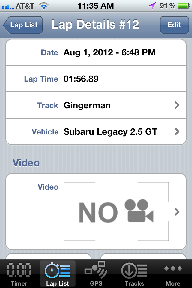

On an unrelated note, I saw in other threads where you mentioned that phone calls should be suppressed by the app or at least not interfere with the app. My wife called in the middle of a session and I saw the call appear on my phone while video recording. This resulted in the video from the entire session not saving.
Since you say this has already been addressed, could this possibly be a bug? See the attached screenshot of what such a lap results in. Let me know if you need more info.
BTW, thanks for the continued support thus far.
Re: Lateral/longitudinal data incorrect?
That's exactly the known issue with v15 and before. Will be fixed in v16.
