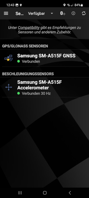

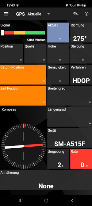

Hi there,
as described in the subject, the app can't get positional data from the internal GPS device. It is listed as connected in the sensors list, but still can't show the actual position. There is no other app, which is accessing GPS. Google Maps is working fine. Please check attached screenshots for further understanding.
Android 13, Laptimer Rookie Edition v25.0.2
Thank you & regards, startklar

A clear view of the sky was the decisive factor. I first tried it between two buildings, but without success. Now I've tried it on an open field and it works. Thank you very much for your support.
Re: Internal GPS sensor can't get position (Samsung Galaxy A51)
No problem, but it emphasizes how important a proper mounting position is. Both Android and iOS provide positions based on triangulation *or* GPS. The former isn‘t usable for track use - which is the reason LapTimer shows „no position“ here. In buildings, you will frequently think you have a proper position where in reality it is just some WiFi / mobile triangulation result.
