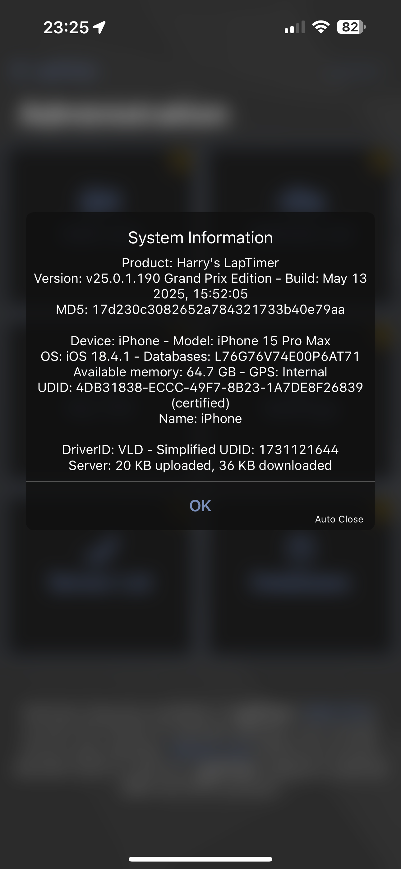

Wait - this looks like the top right sector indicator ("1" in my picture) has been shifted over the center part of the large display covering the ":4" part. Can you reproduce this? I'd be interested to know about the system situation the screen shot has been taken, how many sectors this lap had and whether you have selected any special settings.

I am happy to help you to debug this.
The custom track has a start and finish line, a split section and 3 information points.
Let me know what exactly you want me to provide you.
