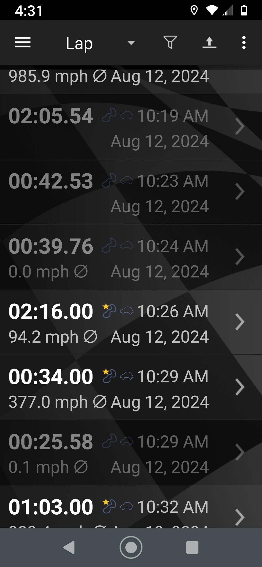

I do not understand what happened…at an Autobahn track day Laptimer developed a mind if its own. It started and stopped over 100 time, some in grid and some on course. Analysis said I ran 132 laps, some at over two hundred MPH in less than 2 minutes, on a track just a little less than 4 miles. I only ran two 20 minutes sessions due to brake failure. I have only two completely recorded runs.

The false starts detected as well as the high speed "measured" indicate there has been a problem with GPS accuracy. Had you mounted the device like shown in illustration #3 of LapTimer's Quick Reference? Furthermore, please make sure
  • you have not checked "Allow Low Speeds" in LapTimer ‣ Administration ‣ Settings ‣ Expert Settings ‣ Trigger Detection
  • you see no warning on track set conflicts; in case you do, reload the track set you are driving and allow LapTimer to purge the conflicting track set when it asks you
