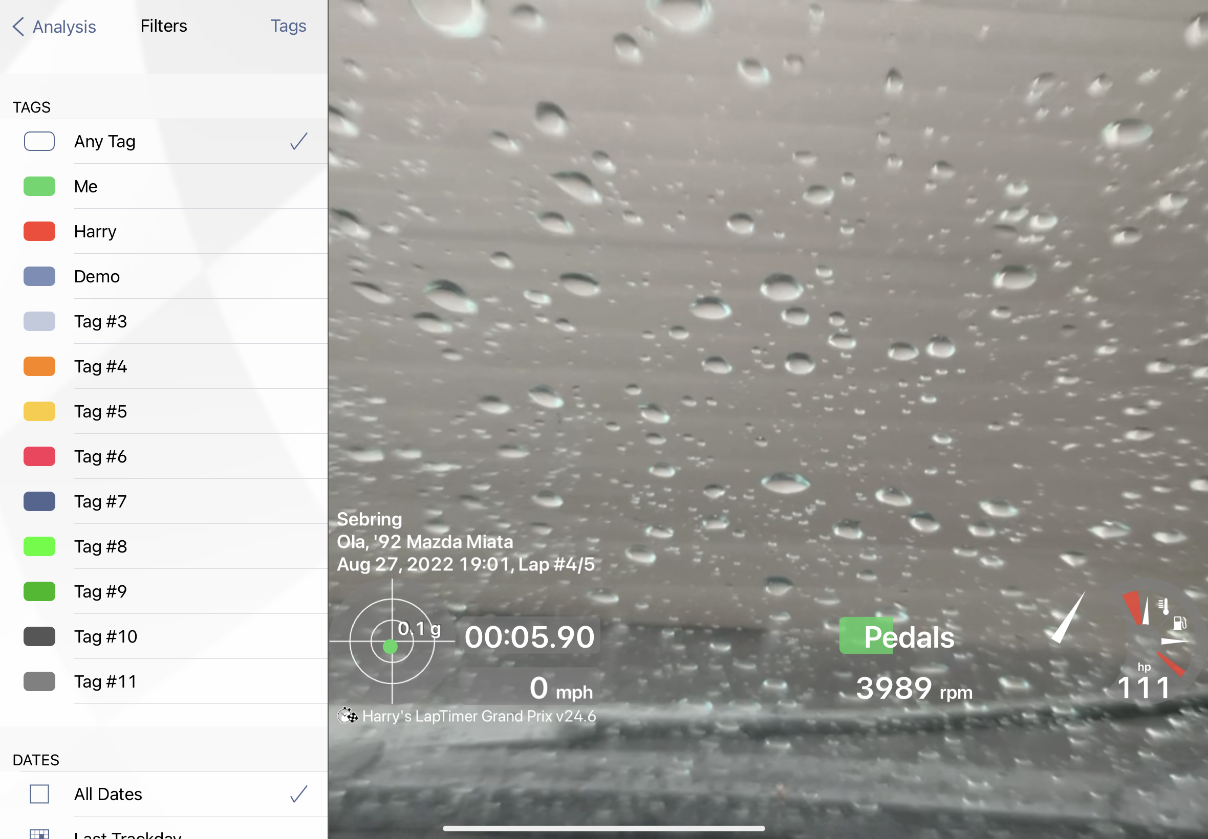

- After I put in engine data (non-stock) the tach rpm show and the needle moves. The 1,000 rpm reference lines and green and red fields show up on the display but not on the video (only needle on video). Why not on video?
- My iPad Air runs iOS 15.6.1. I mount my iPad horizontally and use the built in camera for my forward video. The picture looks ok until the shift warning flashes. At that time the screen turns to vertical. After shifting the screen stays vertical and is all jumbled. I attach screenshot of the shift indicator and the screen after rpm comes down. Before shift indicator came on display was horizontal. The video still seems to come out ok.

For the green / red sectors, please post a snapshot.
I will add this to the list of things to investigate. I need to add, that orientation control doesn't work properly for iPads in all situations. LapTimer needs to control orientation because it has several views available in portrait only. The the shift indicator (which is portrait and landscape) is screwing up orientation needs to be checked. For now, please raise the shift flash vehicle property to 100% and make sure the max rpm is higher than any rpm you will achieve. This will turn off the shift flash.

Harry,As always, thanks for your quick response.
- I will work around the shift light issue for now.
- Attached find a screen shot from a video with no green or red fields and no 1,000 rpm tick marks, and a screen shot showing these items before the video is played.
