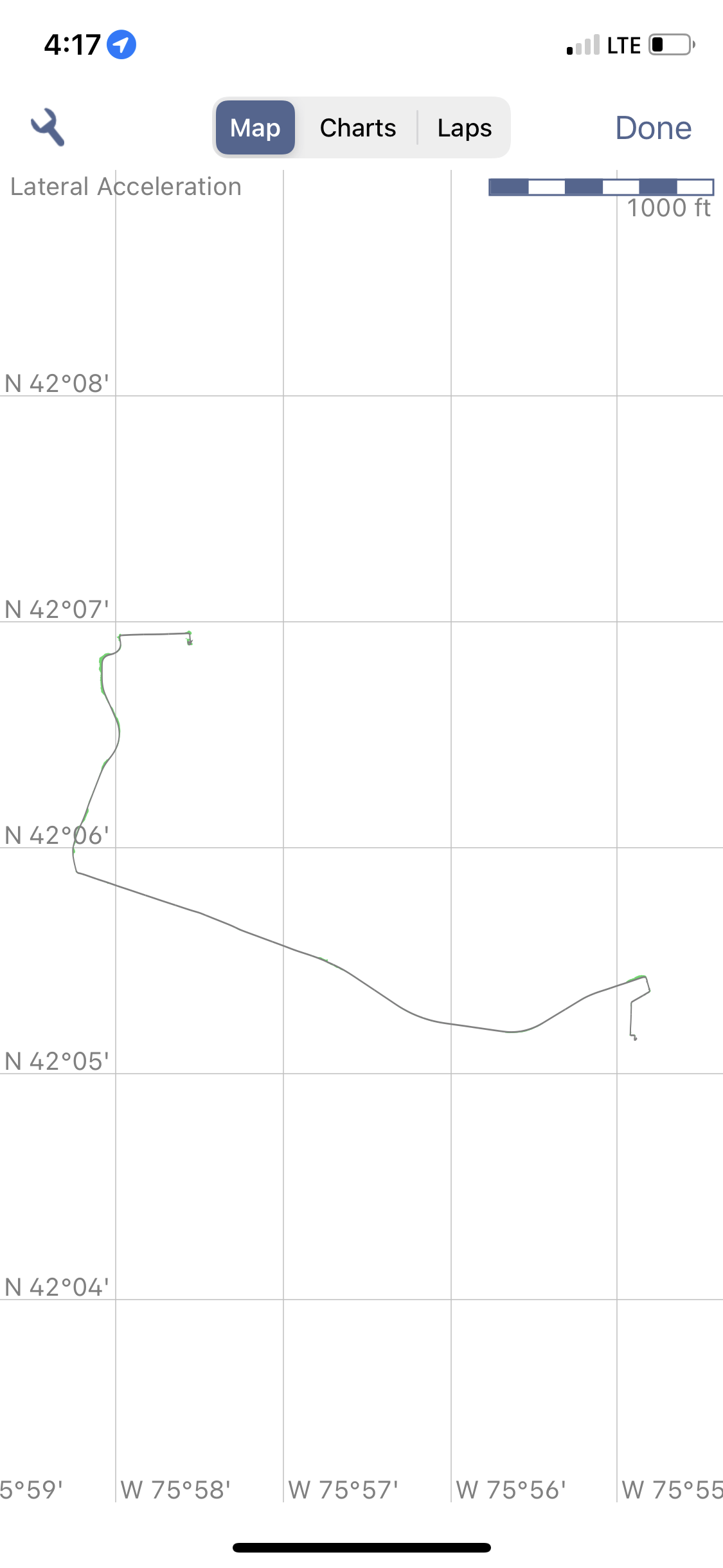

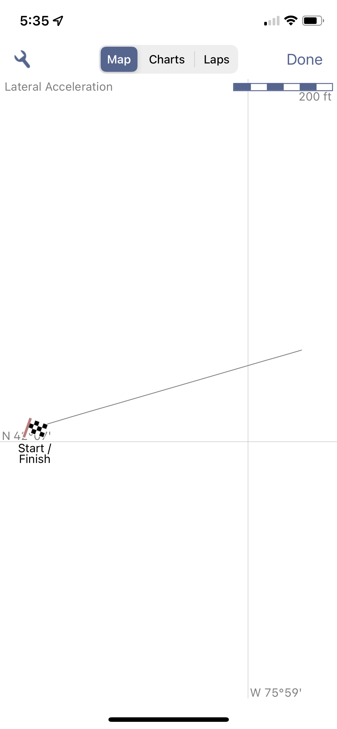

Is the section Data Recording, Charts supposed to show a map or just the path of the lap on a plain white background???
Mike
Data recording Charts.
- map.jpeg (169.28 KiB) Viewed 5292 times
Re: Data recording Charts.
This is supposed to show a map. The problem is that there is are only two positions for this recording? Please go back to Lap Details and let us know what the Data Recording section says. Please add background on how this has been recorded and how other laps look like.

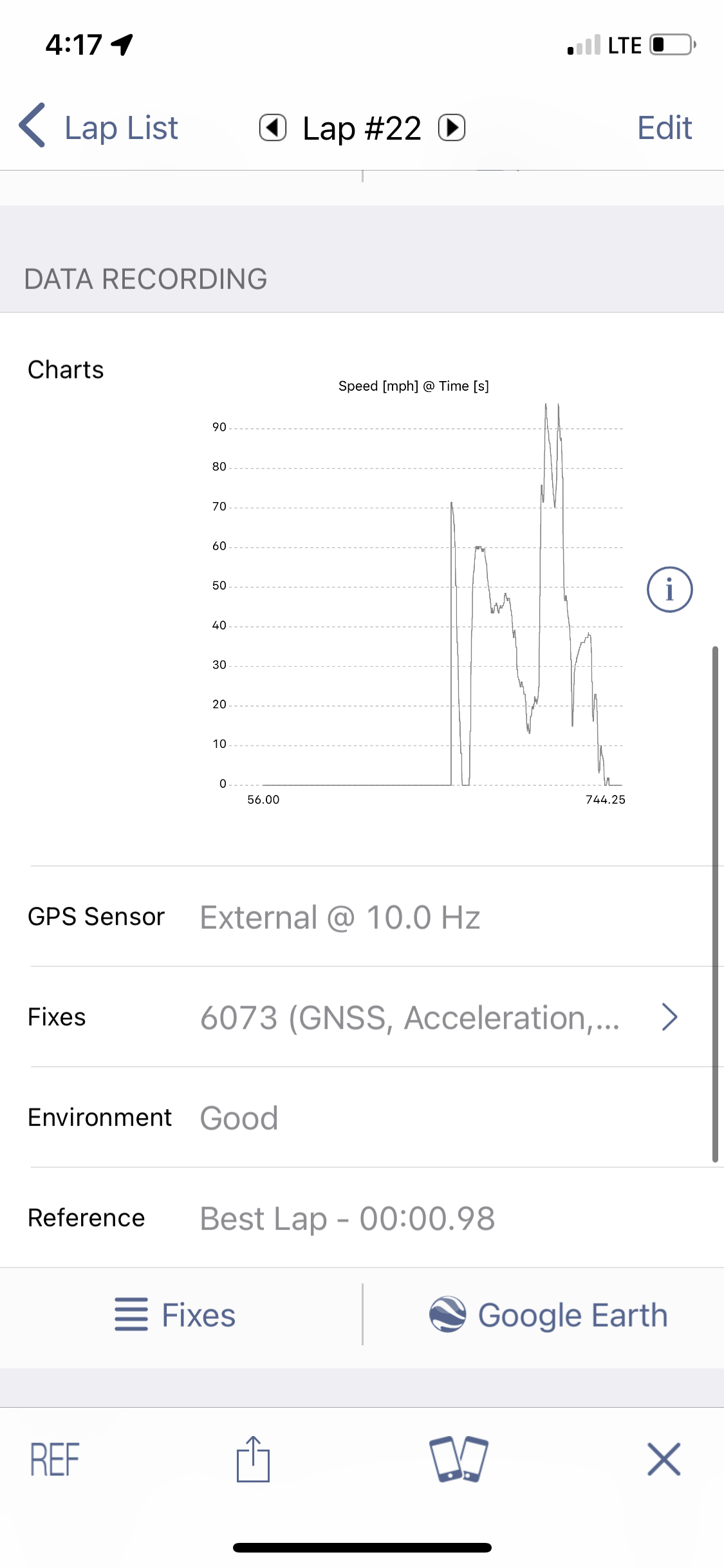

I deleted that lap. Here is another one. I am trying to learn LOL.
Here is another one. With the Data Recording section. It says Google Earth????
At least for the speed chart, there has been a drop of connection. It is well possible, the dropping OBD connection produces trouble for the overall fusion process. I'd suggest to troubleshoot OBD and the general recording issue separately. To fix OBD, please have a look into this FAQ: viewtopic.php?f=39&t=1500. Until this is fixed, do not use the OBD adapter on track.
I doubt the problem is around the distance between adapter and smartphone. Usually the problem is around some incompatibility of the OBD implementation or some real bus fault.
