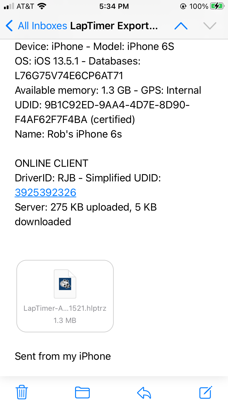

I exported data using iOS 13.5 and after installing IOS 15.1 HLT would not launch so I deleted the app and re-installed. I tried to follow the restore documentation where it states that I should try to open the emailed file from the same device and when I do that nothing happens. HLT is not launched. Data not imported. Please advise.
Re: Transfer data to new phone
Please start with checking the attachment is fine. Open the mail in Mail app and scroll to the bottom with the attachment. Does it show something like LapTimer-##########.hlptrz and the number of bytes? Does the attachment show LapTimer-type icon? In case this is o.k., please open Settings app and navigate to LapTimer. You will see a number of permissions requested. Make sure they are all granted.

When you say permissions are you talking about: Location, Photos Access, Bluetooth Access, Local Network Access, etc? If so, all of that is on. The attachment looks valid it shows as follows.Harry wrote: Tue Nov 23, 2021 11:04 am Please start with checking the attachment is fine. Open the mail in Mail app and scroll to the bottom with the attachment. Does it show something like LapTimer-##########.hlptrz and the number of bytes? Does the attachment show LapTimer-type icon? In case this is o.k., please open Settings app and navigate to LapTimer. You will see a number of permissions requested. Make sure they are all granted.
