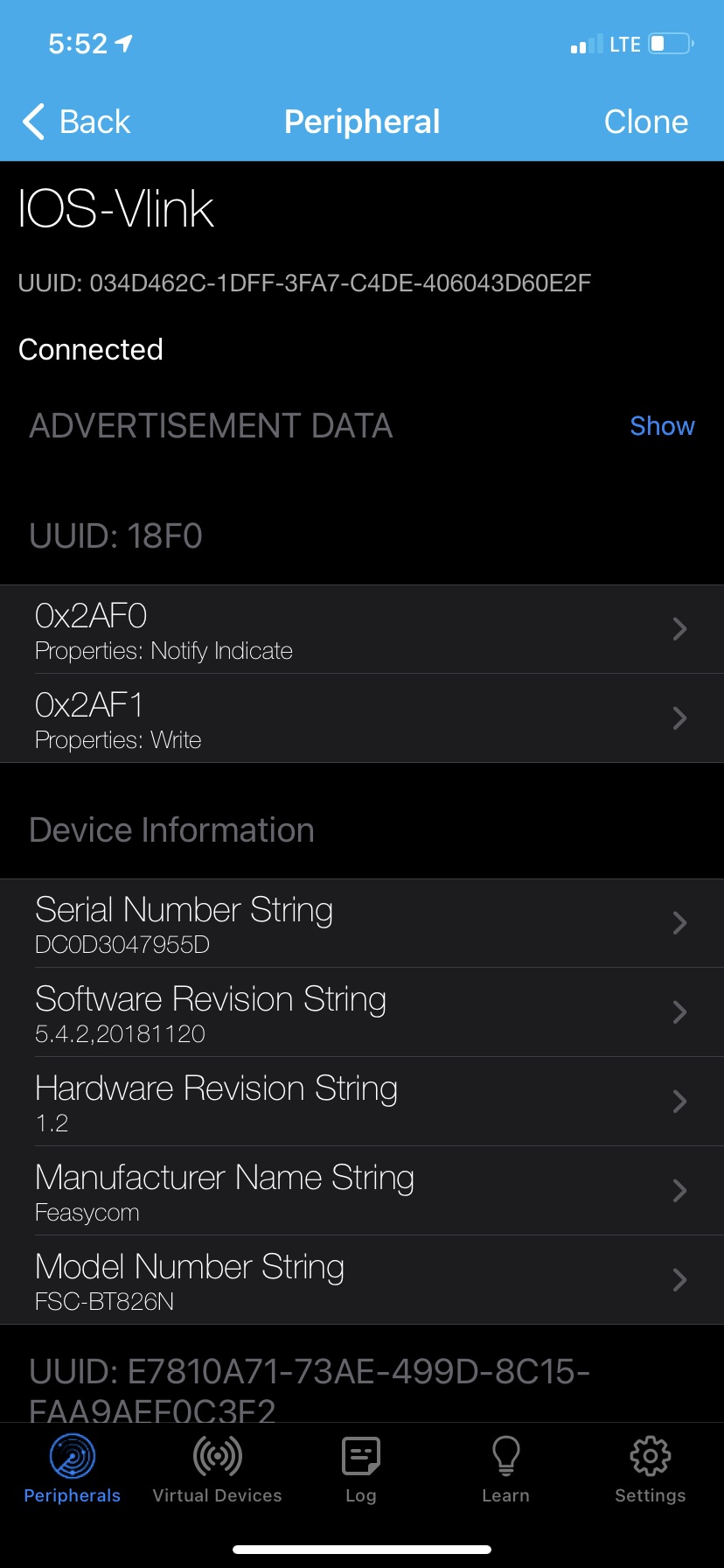

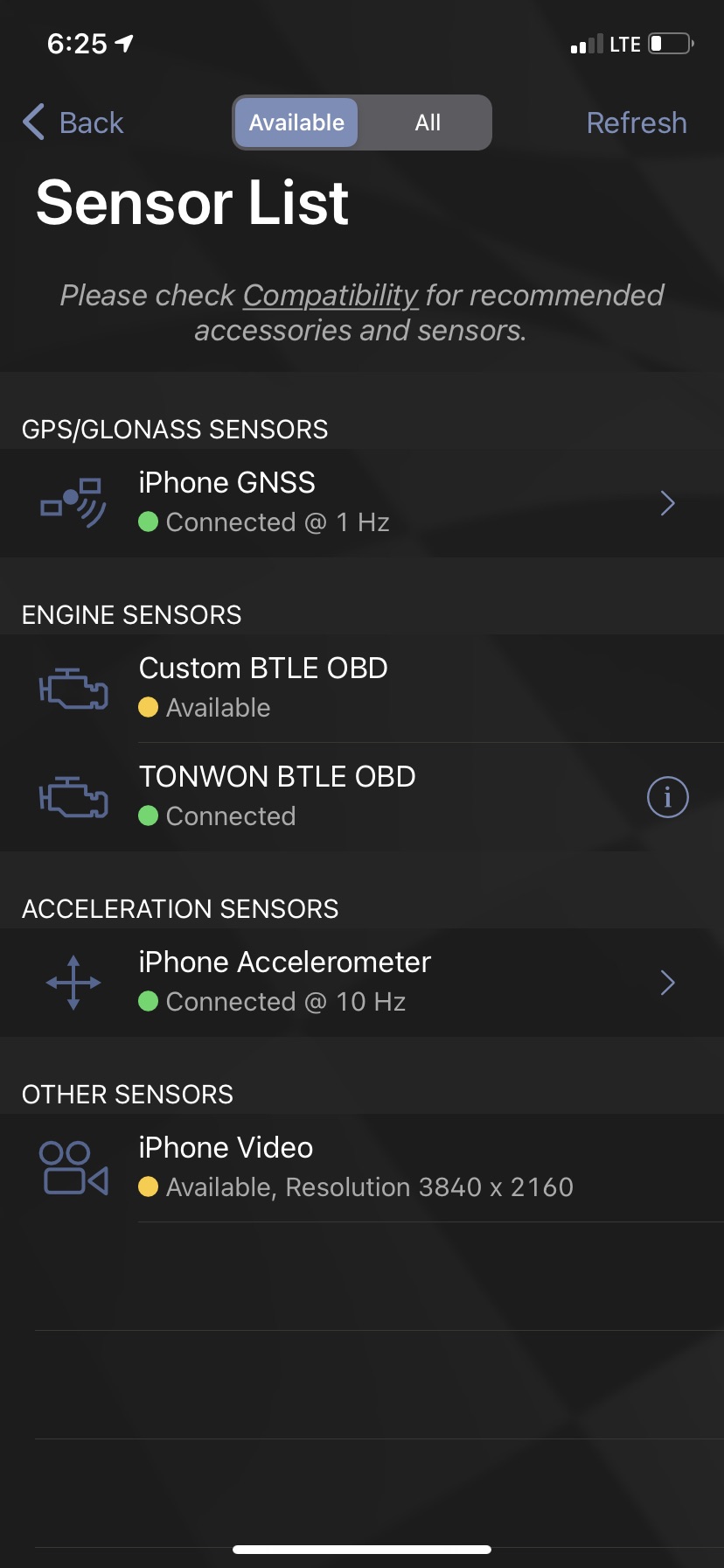

Yesterday I went into HLT’s Expert Settings to update the following values like someone if the Forum suggested, unfortunately it still doesn’t connect (see the attached Sensor List, where Tonwon still shows up with no obvious reason and there is one more “Custom BTLE OBD” showing up but not connected). I’ve also verified below values against LightBlue (see attached too).
@Harry, any recommendations pls?
“IOS-Vlink",
service UUID: 18F0,
read Characteristic: 2AF0,
write Characteristic 2AF1

The TONWON BTLE 4.0 adapter uses the device name "IOS-Vlink" by default. I assume there are several brands using the same manufacturer using the same technical name. The characteristics listed above are the same the TONWON uses too. So please start with removing the custom OBD adapter - it will duplicate things and may result in access conflicts.

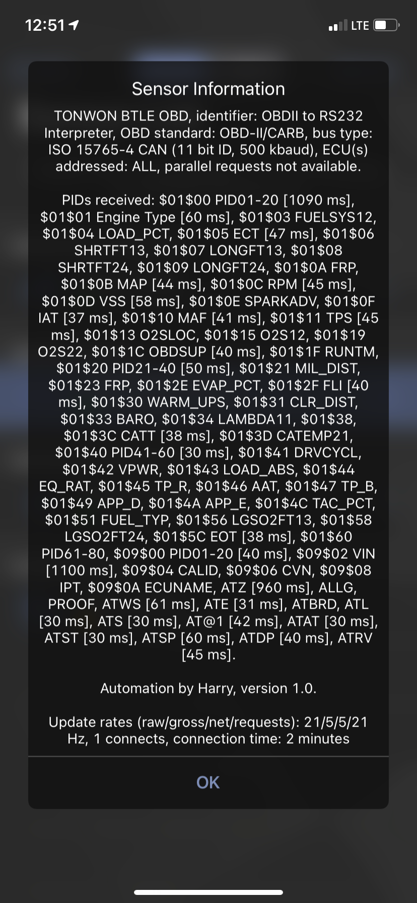

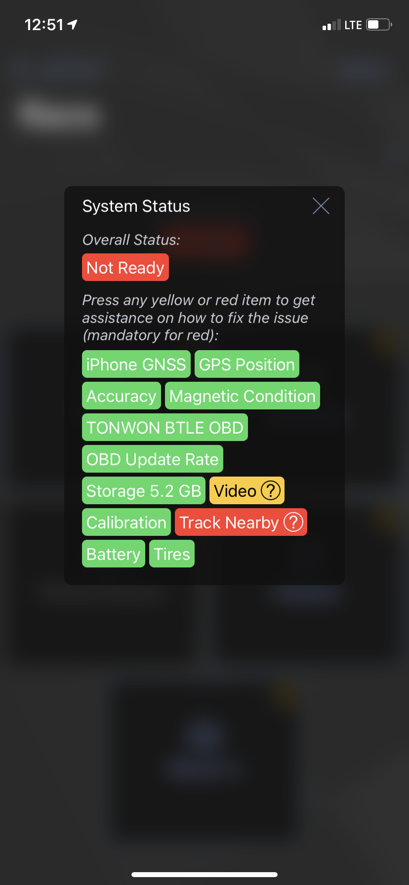

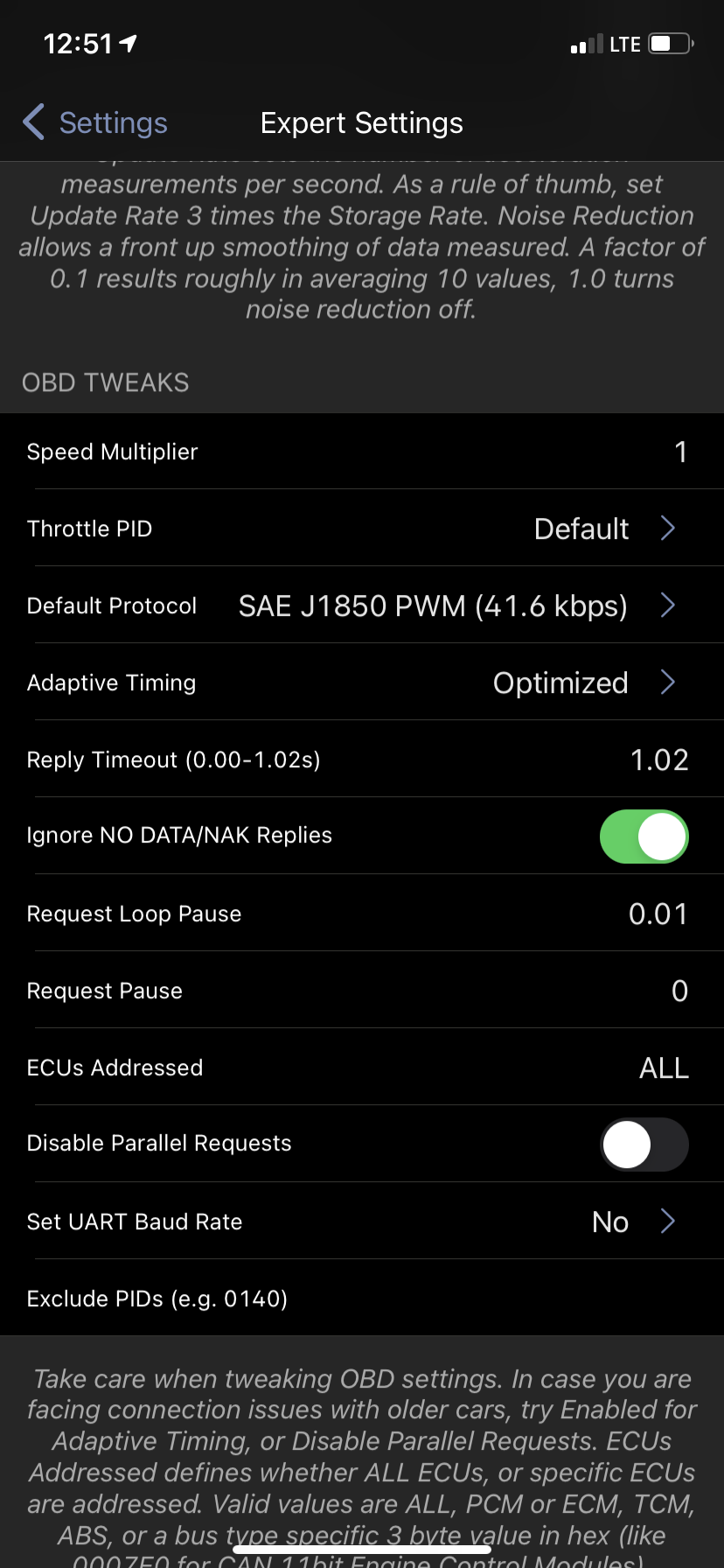

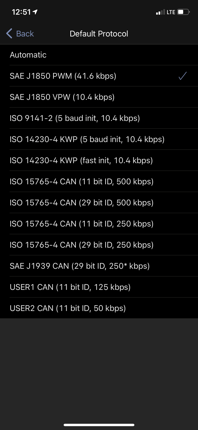

Thx @Harry. When I was to give up on the Vgate iCar Pro, I changed the “Default Protocol” in “OBD Tweaks” to “SAE J1850 PWM” (I tried “SAE J1850 VPW” and it seemed to work too), the status of OBD dongle was no longer in red. Could you please help verify from the below screenshots if connection is fine now?
Just saw from another post that you suggested to use “ISO 15765-4 CAN (11 bit, 500 kbps). Should I use that instead of “SAE J1850 PWM” for my 2018 BMW?

In the top of Sensor Information, you can see that the adapter negotiated the CAN11/500 protocol. Default protocol is kind of a starting point for protocol negotiation…
Anyway, I’d suggest to set CAN as default. Keep my fingers cross.
