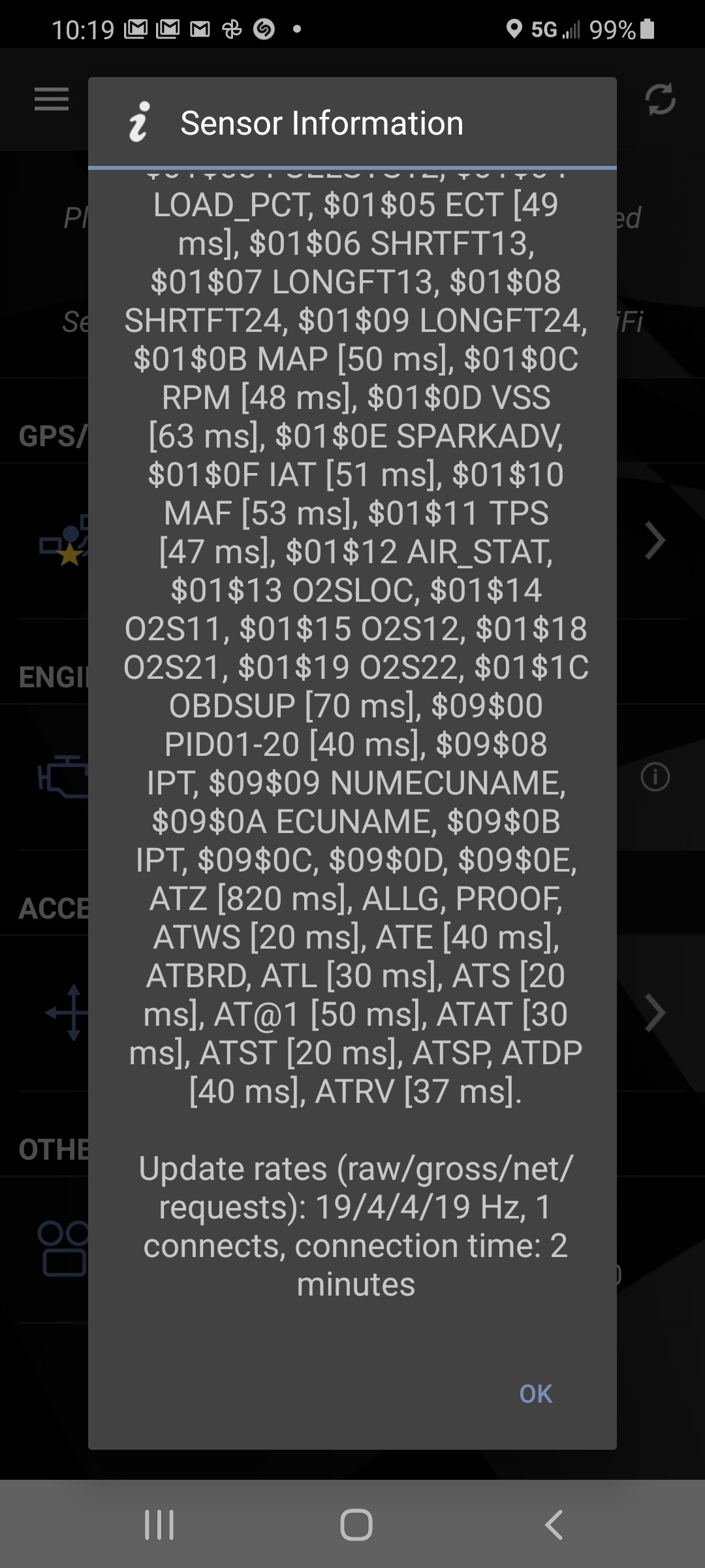

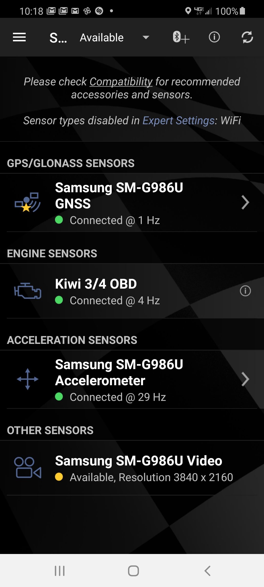

LapTimer v24
- Shows additional information on Kiwi 3
- Screenshot_20201022-101907_LapTimer.jpg (568.48 KiB) Viewed 10064 times
- Shows Information on Kiwi 3
- Screenshot_20201022-101901_LapTimer.jpg (543.22 KiB) Viewed 10064 times
- Shows Kiwi 3 Connected at 4 Hz.
- Screenshot_20201022-101847_LapTimer.jpg (477.98 KiB) Viewed 10064 times

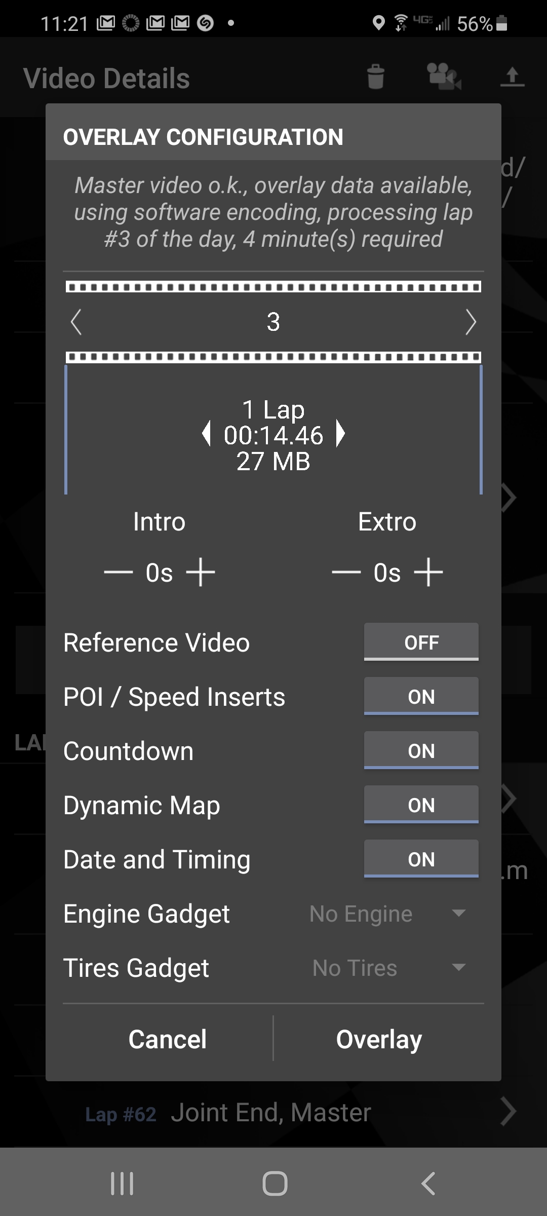

Unfortunately when I check the video settings in the fixes I'm not getting the ENGINE at all anymore for some reason and I was before (although not consistently but I can live with it not being consistent if I can get it working sometimes which I cannot now).
So if I have a good ODB connection showing then why I am not seeing the ENGINE fix and I get no ENGINE Gadget showing in the recordings? At the beginning and at the end of the recording I have everything showing GREEN in the System Status (except for a track nearby) including the ODB update rate but still no ENGINE Gadget showing. Could it be my Kiwi 3 is bad or maybe I should uninstall HLT and then reinstall (I have done a backup of my videos). Any other suggestions? Note that in the timer mode I am getting the RPMs showing in HLT as shown in the pictures below so I'm clearing getting data from the ODB Kiwi 3 to HLT - just not the ENGINE Gadget showing (note that one of the pictures shows two little icons in the lower right hand corner where the ENGINE Gadget should be - one looks like a guage and the other is clearly a lock icon - maybe indicating that the ENGINE Gadget is locked somehow?).

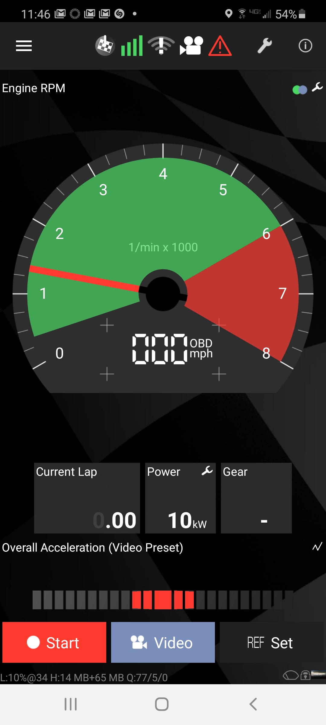

- Shows Engine Gadget no available??? Why?
- Screenshot_20201026-112112_LapTimer.jpg (343.03 KiB) Viewed 10051 times
- Speed showing that Engine RPMs are working
- Screenshot_20201026-114620_LapTimer.jpg (342.66 KiB) Viewed 10051 times

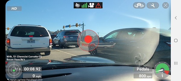

Last picture showing that the Engine Gadget is not showing in the Video mode and that I have two little icons - a guage icon and a Lock Icon. What is the lock icon indicating?
Will
Will
- Shows no Engine Gadget and a lock icon
- Screenshot_20201026-111421_LapTimer.jpg (1.21 MiB) Viewed 10051 times
Re: LapTimer v24
The lock means the screen orientation is locked and will not change independent from device orientation. That's a hint added when Display Details are increased above Plain. But there is a problem with the missing gauges - they should be there. I will check, but it will require an update to make them visible again.
Re: LapTimer v24
Problem fixed, it will get available in v24.0.2. I have not tried, but chances are good you get the gauge once you start to drive (speed > 5mph) for 24.0.1 too.

Re: LapTimer v24
Hi Harry!
Well I downloaded the 24.0.2 update last night and I took the Vette for a test ride at lunch today! At first the Engine Gadget was not showing so I did the usual stuff including restarting HLT, turning on and off the Bluetooth on the phone, pulling out and reinserting the Kiwi 3, etc. I was still not showing the Engine gadget in video preview mode (Timer or Speed odometer) but I was getting engine RPMs. We somewhere down the road it started working finally! So i toggled between the timer and speed odometer modes ands the engine gadget was still working. When I got home I shut down HLT and then restarted while sitting still in the driveway and the engine gadget was still working! So I have functionality. I'll keep testing it out over the next two weeks and then back at Summit Point, WV on Friday the 19th of Nov which I hope to be able to capture all the engine information during the laps! Again, thank you so much for the support and especially how prompt the support is! HLT is by far the best program and best support!
will
will
- Showing a working Engine Gadget again!
- Screenshot_20201103-121357_LapTimer.jpg (56.22 KiB) Viewed 9986 times
