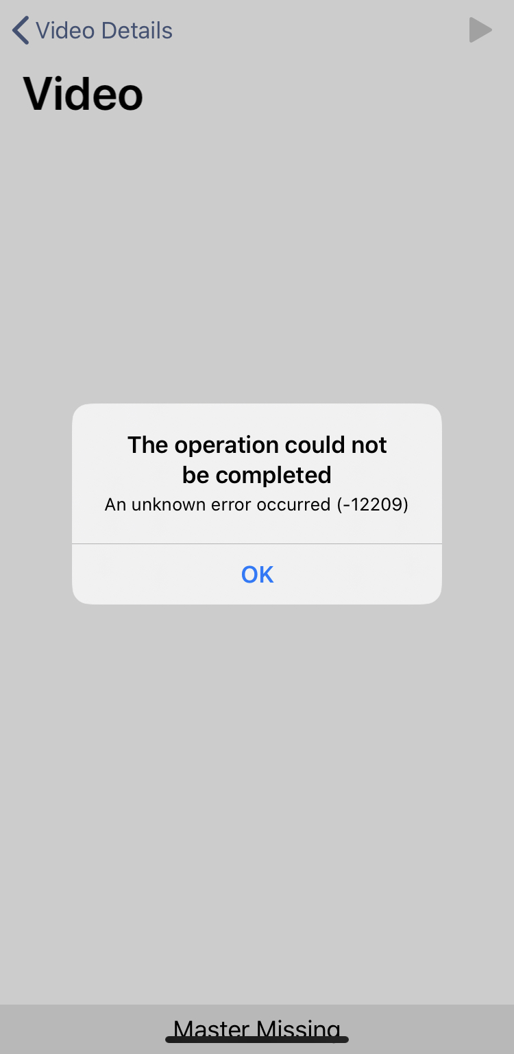

I’m unable to re-link the video, getting following error messages. I don’t come to the video selection menu.

That's difficult to answer from the snapshots. The error is saying the video selected is not available in the place the link followed points to. Please follow Lap List ‣ a lap ‣ Video / Preview ‣ Relink to get a list of videos available for re-link.

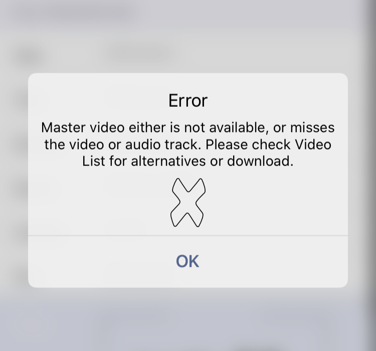

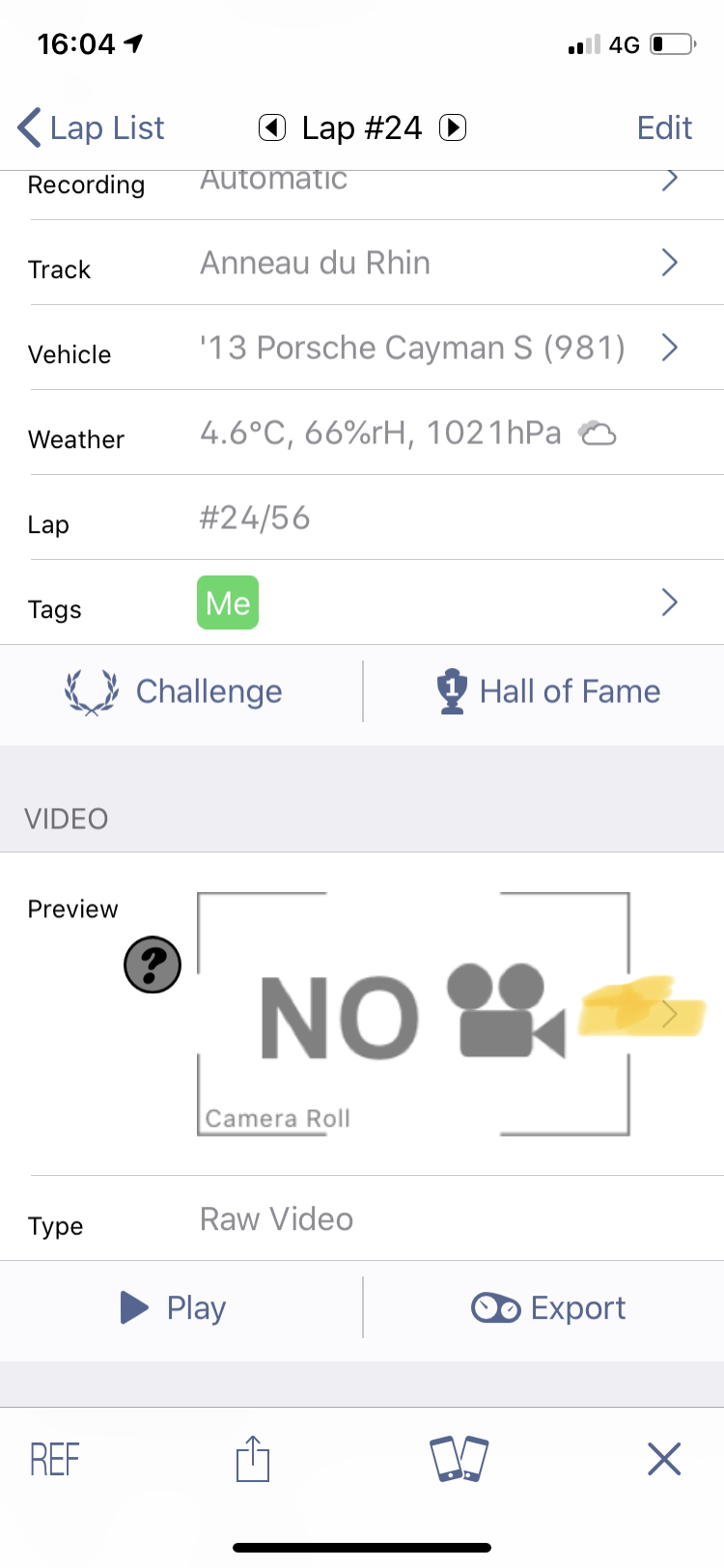

Hello, the problem is that i don’t even reach the video list. Here are the screenshots one after the other starting from the selected lap. I marked yellow the area where i selected. After these 2 screens i arrive to the error message included in my first post. Thanks in advance for help

On the screen shown in the second snapshot, select the Re-Link icon in the bottom left, not the Video thumbnail. This will open the Video List and allow you to associate the correct video.

Great, that was the solution !
