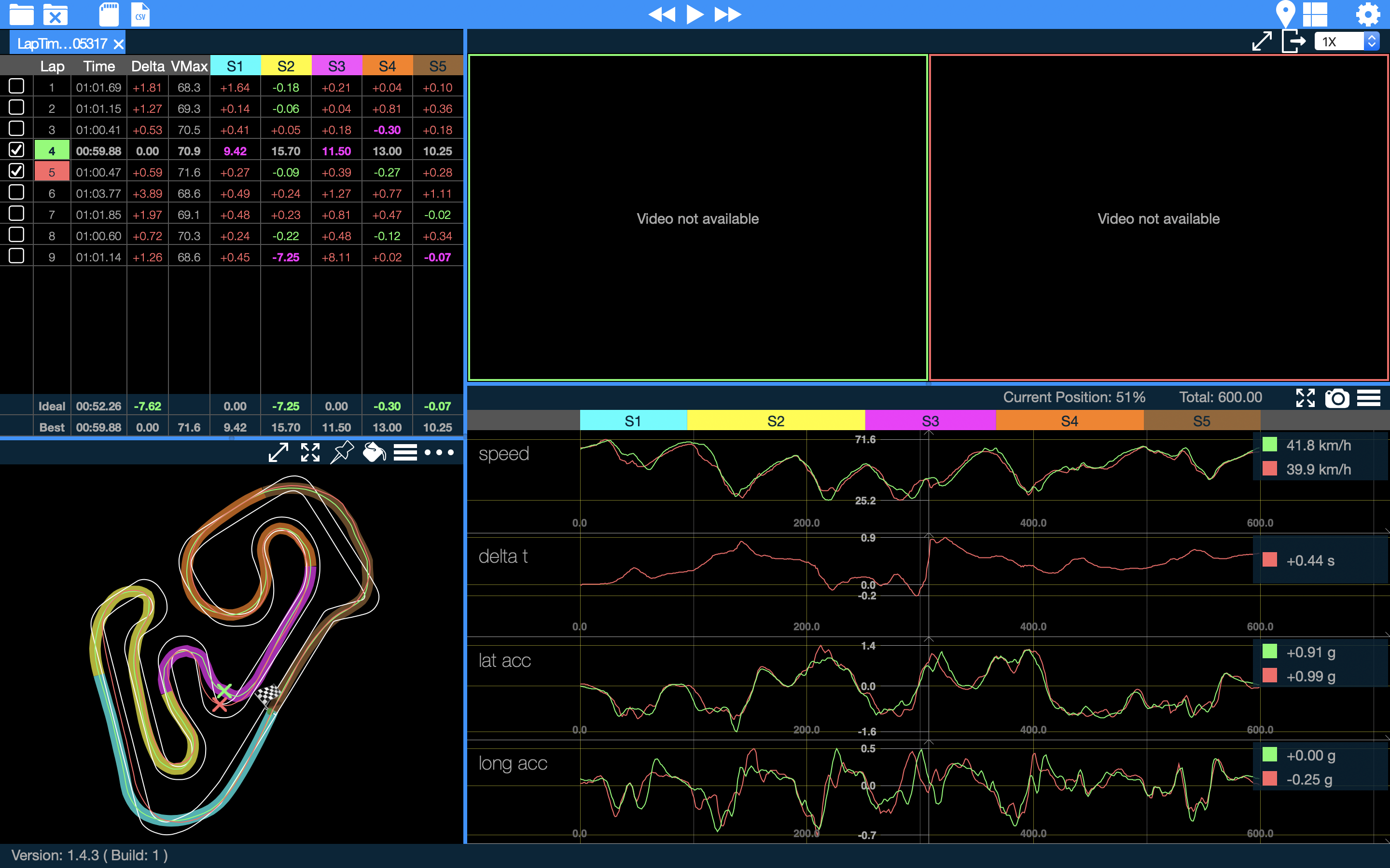

I was wondering if I could have some help importing laps to Circuit Tools please?
I'm exporting the session from the current version of laptimer on my iPhone and using AirDrop to send it to my Mac. When I open the file in Circuit Tools it identifies the track correctly but the number of laps is incorrect. The correct number is 33 but Circuit Tools lists over 60. From looking at the lap times I think each sector is being treated as a separate lap.
The track map is also not being displayed correctly, with only the first sector being shown.
I've attached a screenshot.
Screenshot 2020-03-01 at 17.13.07.png (861.16 KiB) Viewed 2002 times
In LapTimer, all 24 laps are shown correctly.
Any ideas on how to resolve this please?
Doug

Boom! I managed to get this to work by adjusting the 'gate width' setting down to its minimum value of 10. Maybe its to do with it being a Karting circuit and a lot tighter than a car circuit.
Screenshot 2020-03-08 at 21.00.18.png (1.25 MiB) Viewed 1977 times
