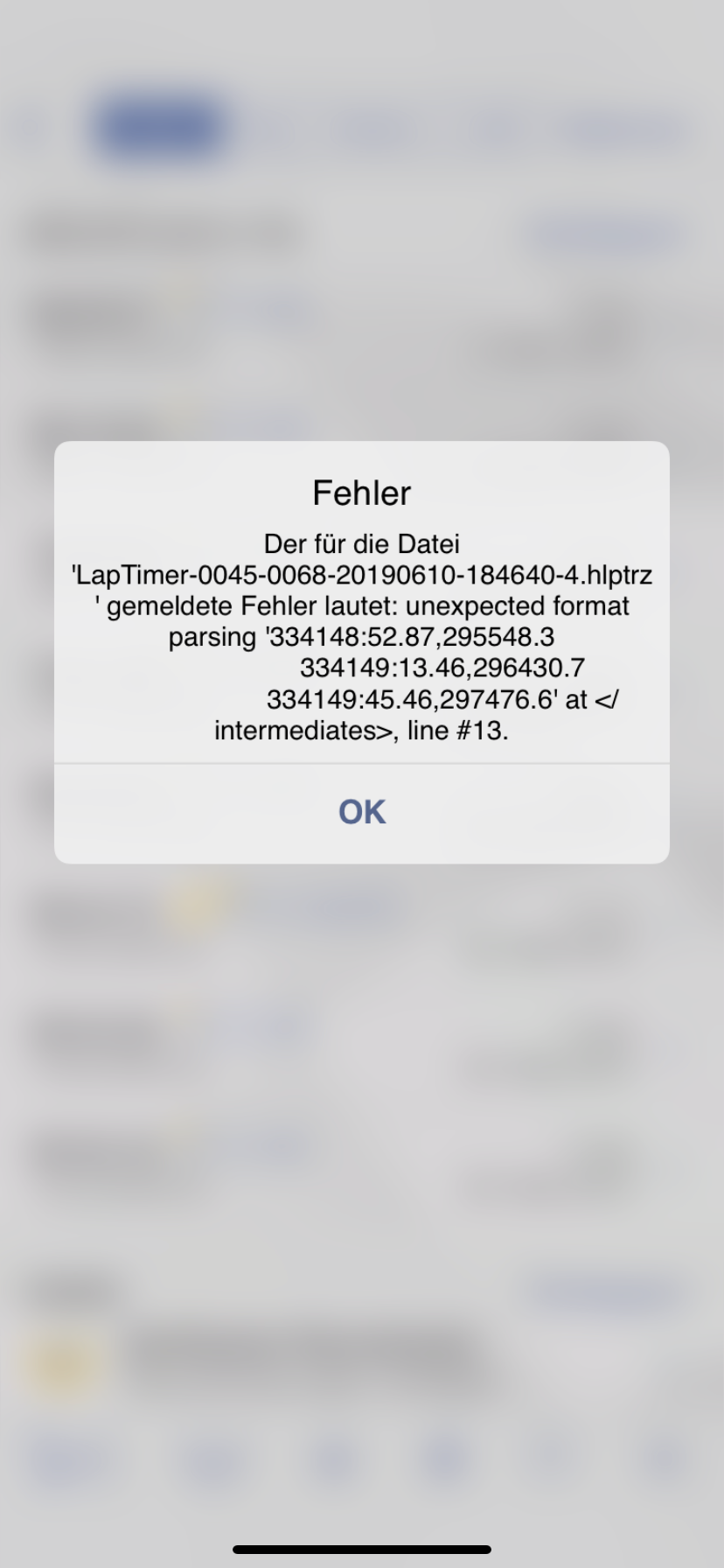

I was trying to import track day data from a friend. Phone to phone did not work, don't remember the error but it basically started the export and import but did not save any data.
I then did an export but that gives an error too:
Any way I can re-format that part to make it work?

This type of corrupt timestamps occurred for some pre-v23 versions and can still occur for manual recordings. Check Data will fix this often, but not always. Laps with this type will often show up with ridiculous lap times in Lap List too. I recommend to delete them completely. The export can be edited manually too, on Unix based machines, try
Code: Select all
cat LapTimer*.hlptrz | gunzip > LapTimer.hlptrl
to get an editable file.

I had managed to rename and unzip the file, but what do I have to change manually in the file?
Re: Errors importing track day data
This depends on the actual content. :-)
You can remove intermediate sections completely. They can be recreated using one of the Recalculate functions at any time. Take care to remove both opening and closing tags so the file is still valid XML.

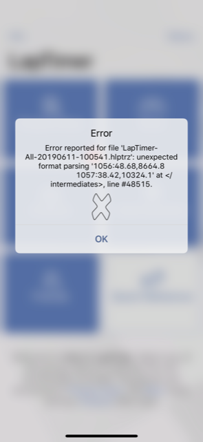

I have the same issue. I recorded 2 track days this weekend and tried transferring from iPhone7 to iPhoneX. It transfers only the laps from the first day. Tried multiple times, laps, database but it always comes back with the "parsing error" message similar to the first post. I even erased the older phone and restored from itunes backup and all the laps (both days) were restored but again only the first day laps transfer to the new phone. Database check says OK.
What else should I try?

Ok, so I edited the file and put it back on my iPhone and this time the import worked. I see the times, calculated average speed, date, car...but none of the diagrams show any data or GPS fixes and therefore I can't do any of the re-calcuklations...never have had this type of issues before.
Edit: There was a very long lap recording, basically a "misfire" from within the box...deleted that one and now import and data are fine, thanks for the support.
F82GTS wrote: Thu Jun 13, 2019 6:28 pm Hi,
Please post a snapshot of the error message like bulls23 did.
Post by F82GTS »
Here you go.
thumbnail_IMG_0053 (1).png (621.89 KiB) Viewed 29175 times
thumbnail_IMG_0051 (1).png (608.48 KiB) Viewed 29175 times
It is probably the 18th lap included in the export that triggers this issue. Please remove the complete section from <intermediates> to </intermediates> to allow an import:
1) Rename the .hlptrz file to .hlptrl.gz
2) Use Ungzip to remove compression and get the .hlptrl file
3) Open that file using a plain text editor (e.g. Notepad)
4) Search for "1056:48.68" to find the named <intermediates> section
5) Remove everything from <intermediates> to </intermediates>
6) Save the file and send it by email to yourself
7) Open the .hlptrl file on your smartphone
NB: every import will add laps, so the 17 laps you got a message on before show up as duplicates. You need to delete these manually.
