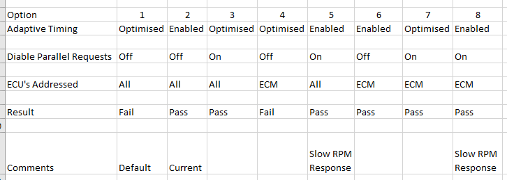

Post by Touring_Dave »
Harry wrote: Wed Apr 10, 2019 2:47 pm Fine, but please try to turn on one of the first and second. This willl speed up the update rate.
Feedback as promised:
Unless you recommend a different setting I have set it to Option 2 which was the first one to work.
Comments for Options 5 and 8 for your info in case of use.
Once again, many thanks for your help.
Dave.

Re: OBD previously worked, now outside of range?
Thanks for the efforts. :-) Option 6 should be a bit faster than 2?
Once LapTimer v23 is getting available, please try option 4. It should be faster than 2 or 6. I have worked on some answering patterns I have seen for beta testers - well possible it has been the same issue you have been facing. Thanks again.

Harry wrote: Wed Apr 10, 2019 5:12 pm Option 6 should be a bit faster than 2?
Will try again but unfortunately it won't be possible before the weekend...
Mazda MX-5 (Miata) NC 2ltr, IL Motorsport Manifold, Cold Air Intake, Ecutek remap, Skuzzle Dyno 164hp at wheels, EBC Turbo Groove discs and Yellowstuff pads front and rear, Meistrr Coilovers.
You can keep it like it is, I just wanted to show the option to get a bit faster updates. :-)
