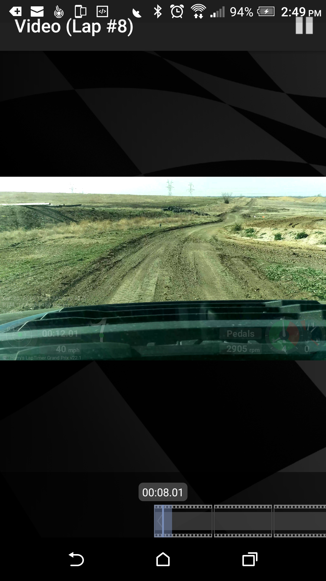

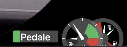

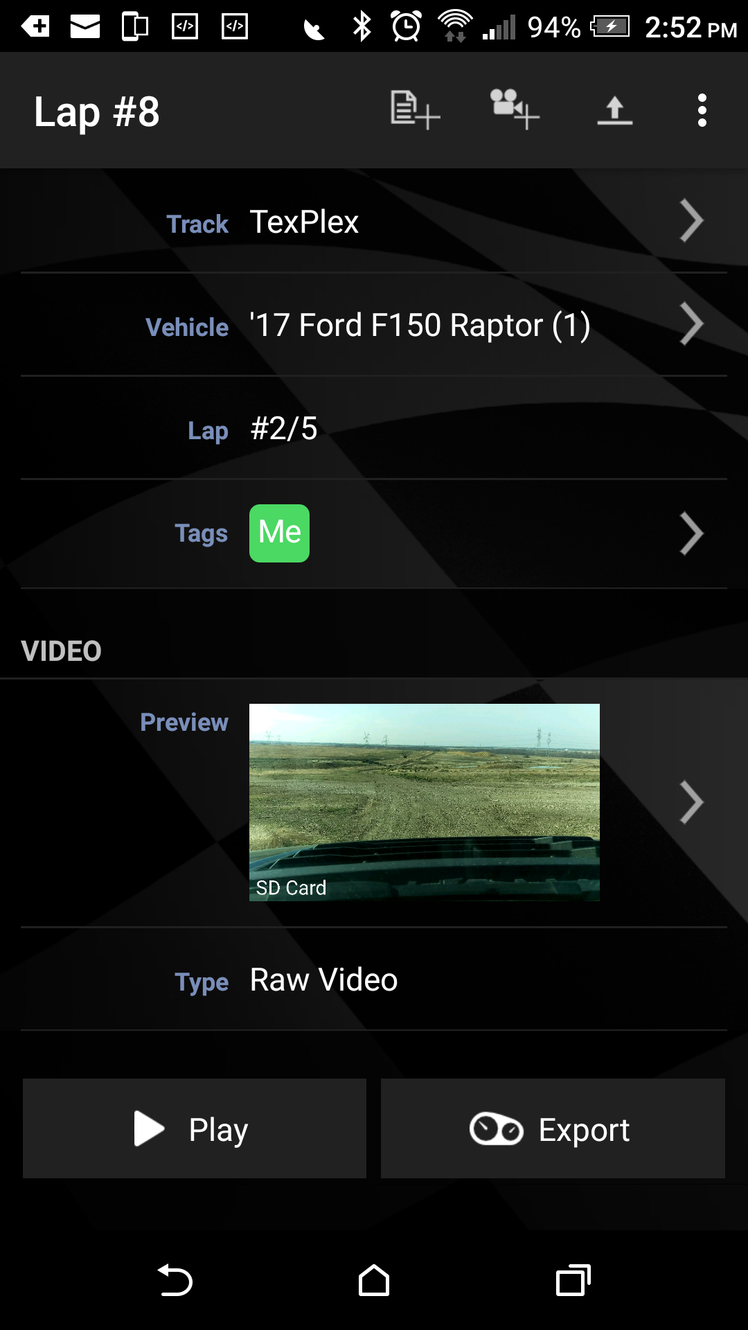

O.k., I have imported the car and the lap and get a proper rpm gauge display after adding an arbitrary video. The lap you had sent had been exported to an overlaid video already. As these exported videos have gauges added and are not reevaluated when playing them, please revert to the Original video (i.e. Original button in the lap's details) first and press Play afterwards. This should show the gauge as expected. You need to export the video with the now up to date rpm data again to get a distributable version.
Screen Shot 2019-02-04 at 18.44.29.png (41.58 KiB) Viewed 6767 times

Hmm...still doing it on my end. After reverting and allowing the app to overlay on the fly, still same as before.

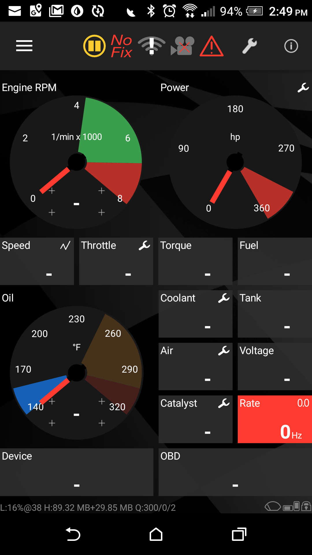

I've been playing around in settings. I think there is some bug in the vehicle created - because after making a duplicate and selecting the original, the engine tab gauge displayed incorrectly. Selecting the duplicate vehicle and going back to Engine shows correct tach, but trying to display raw video with either vehicle gives results as before. I suspect that these conflicting files are somehow causing the problem.

I purged all vehicles, verified the laps all went to 'unspecified vehicle', then re-imported the vehicle I sent to you. After relinking the vehicle to the laps associated with the trackday, I played the raw video and had the same problem.

Well, I give up. Uninstalled and wiped everything, rebuilt my settings and vehicle from scratch. Went to do video preview prior to starting manual record, and same thing as before.
The only other thing I can think of that might fix it at this point is to adjust the max power values and rpm ranges, and see if that causes changes on the overlay. If it works or I find another fix I'll report back; otherwise I guess I'm just going to have to live with it.
