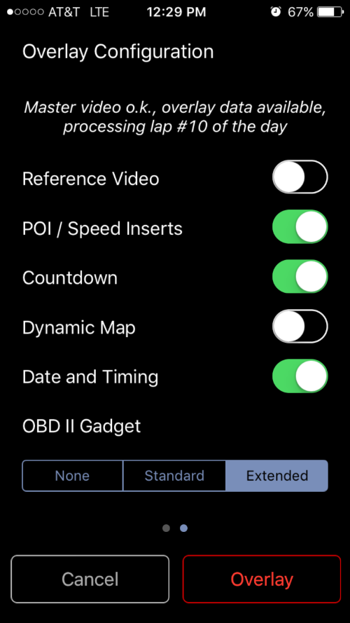

I don't see the GPS speed option here, I tried scrolling and what you see in the pic is all there is. I do remember seeing it somewhere while messing with the app before, but now that I want to export stuff I can't find it anymore...
Re: Kiwi3 and XGPS160 BT on iOS (iPhone 6S) problems
I'm sorry, I have moved this setting to LapTimer ‣ Administration ‣ Settings ‣ Expert Settings ‣ Video Tweaks some time ago.
