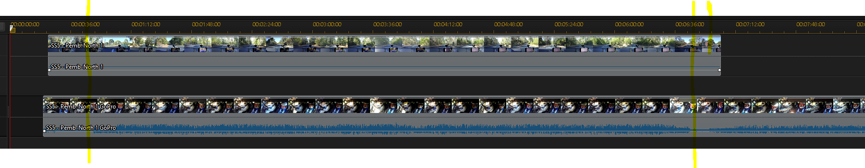

Thanks Harry, it's easier said than done to be honest, here is a picture of the videos, the yellow lines show actual start/finish, and I have aligned the two videos. the yellow markers show the actual start and finish, the sound wave is key in the rally / or rally sprint videos as you can see when the noise comes on / off.
Note these two videos are from 2 external camera's the phone quality is just too shaky, I have a new mount to hopefully help, so this does not show the phone video which is yet another timeline.. as you can see it ends up being impossible for me to produce a video of these external videos and then overlay on the phone to match.
See attached.

What's the problem to select the finish line position shown in the snapshots?
