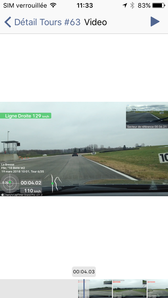

nein, leider nicht. When I do that I come with a video like that: right PIP but no obd
pic 6.PNG (345.54 KiB) Viewed 1992 times

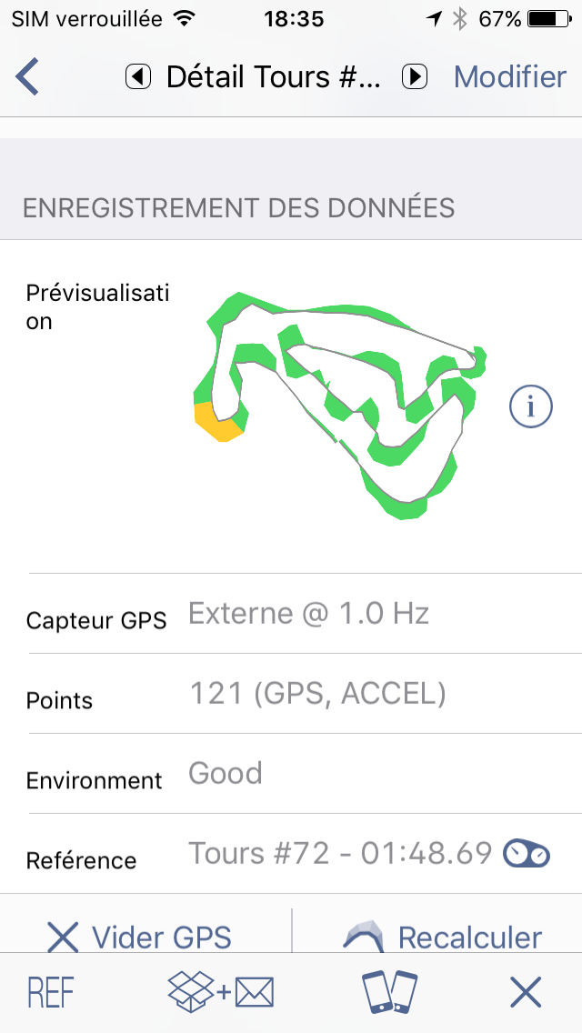

O.k., please export the single lap showing this issue to .hlptrl and send it to me. In addition, please check what is shown for this lap in Lap List ‣ this lap (Lap Details) ‣ Data Recordings / Fixes.

Harry wrote:O.k., please export the single lap showing this issue to .hlptrl and send it to me. In addition, please check what is shown for this lap in Lap List ‣ this lap (Lap Details) ‣ Data Recordings / Fixes.
cannot find the "data recordings / fixes in lap details...
Re: Laptimer, metadata and video
In the English localization, the Lap Details / Data Recordings section is made up from these rows:
- Preview
- GPS Sensor
- Fixes (something like "809 (GPS, ACCEL, OBD)")
- Environment
- Reference
Orfish
Posts: 18
Joined: Sun Nov 01, 2015 7:54 am
Post by Orfish »
ok, now I can't find which lap I exported to you, but here are informations for lap 8/35.
There is no OBD. But it was before I changed the ref lap.
On the lap 22/35, there is still OBD, but the PIP is wrong. If I come back to "original" and export again, I will lose OBD, that's what happened to laps already exported....
pic 7.PNG (110.94 KiB) Viewed 1988 times
I assume you mixed up laps / videos. Once OBD is stored with a lap, there is no way it can disappear. OBD is always stored together with GPS (if available), this is "all or nothing". LapTimer will report "OBD" in the fixes row in case engine data is non-zero. Same for "ACCEL" and acceleration data.
