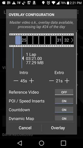

Harry, to further qualify this issue, when I attempt to export, I am getting the notification about "Number of laps avail for multi lap overlays reduced due to inconsistent sync points....". Then when I click ok, I get a screen with incomplete laps as shown in attached screen shot. The session starts with lap 23, which I cannot include with this dialog.
So I guess I am asking how to correct these sync points manually.
Also, why is this happening? Is it due to inaccurate GPS data? Would an external GPS bluetooth unit help? Or is it a bug within Android/LapTimer?
Doug
2018 Shelby GT350 - Leadfoot Gray with black strip

Re: Export error - sync points
