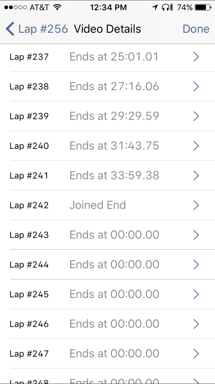

It looks like there is a bug with longer sessions where videos are joined (not sure why it would stop recording and start again). This is what the video list looks like at the end of the 15th lap:
It doesn't seem possible to export VBO data w/joined video info for laps after #15 (either full session or single laps).
