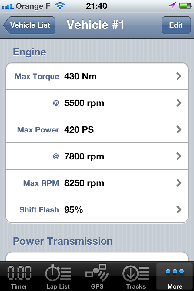

So far all went well, except for the display of the Engine RPM. I have setup my RS4 data:
- Max Torque = 430 NM @ 5500 RPM
- Max Power = 420 PS @ 7800 RPM
- Max RPM = 8250 RPM
- Shift Flash = 95%

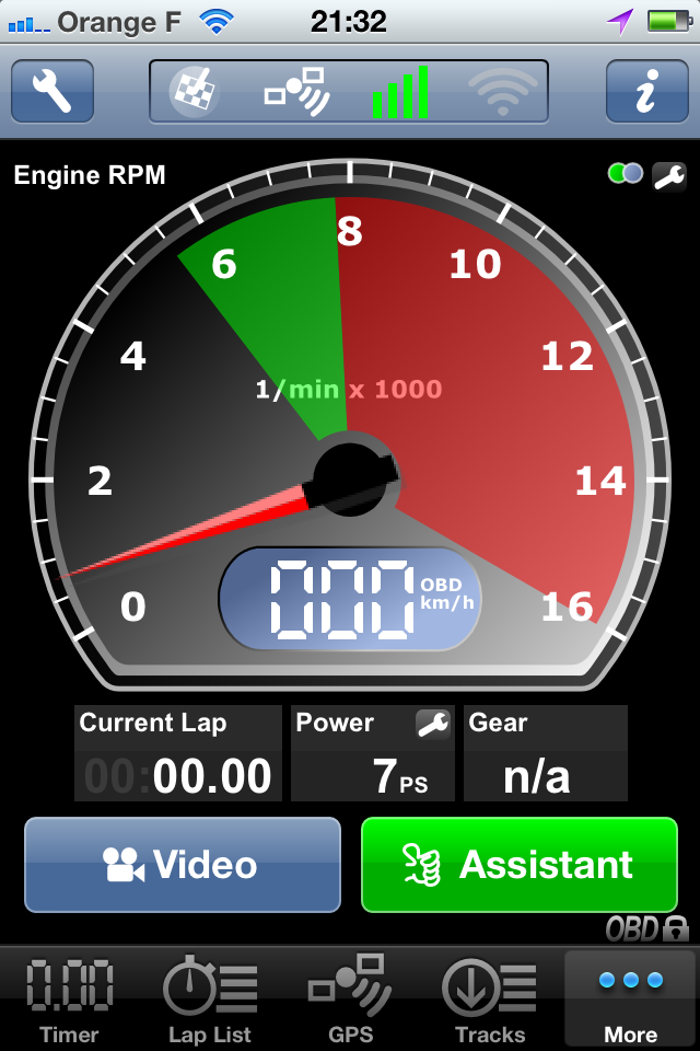

The speedo view shows following:
- regular background = 0 to 5500 RPM
- green area = 5500 to 7800 RPM
- read area = 7800 to 16000 RPM
I've attached 2 screenshots from the iPhone - it is pretty disturbing to see a red zone from 7800 to 1600 RPMs :-)
Have I done anything wrong or is there a bug to be fixed?

Vehicule Data screenshot
Engine RPM screenshot

LapTimer comes with two scales for the RPM meter: one for cars up to 8000rpm and one for motorbikes up to 16000rpm. As your max rpm is above 8000, LapTimer chooses the motorbike scale. As your car tries to, but is not a real motorbike :-) , the display looks a little odd. I'd suggest to simply change your max rpm to 8000. This will change the display. The only thing that changes except the scale, are the max speeds per gear in the small chart in Vehicle Details.

I have tried as you suggested to set the max RPM to 8000. It did not change anything in the display. I then tried to set it to 7999 and the RPM display remains unchanged.

Checked this again, the scale is currently set according to the RPM at max power, not the max RPM. So please change this, you should see the effect immediately. I will change the scaling to use the max RPM in v15.

The implementation for the scale has not been updated after introduction of max RPM (I believe I introduced it in v14). So what I did before max RPM introduction is that I used the RPM at max power, added a little contingency (I believe 10%), and made finally sure this resulting number is visible within the scale. So you need to set max power RPM * 10% < 8000 to get the 8000rpm scale. As stated above, I have updated v15 already to use max RPM. So this will go away when it becomes available.
