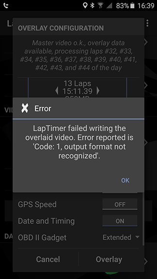

I'm still having (huge) problems :-/
I managed to get the sync correct, but still can't render out the overlay:
Re: Help Galaxy S5 Neo
Sorry, the thread is already too long to get the context: 1) does this happen for internal videos too? 2) Does this happen when selecting on lap too?

I'm sorry, I'm getting error messages all over the place, and don't have any more time to troubleshoot it :-/
Is there a procedure for doing a completely clean re-install?
I'm going on my first Nürburgring trip Wednesday and I'd really like if I could record all 4 days safely and deal with rendering bugs when I get home :-)
Delete the app and install it from the store again.
