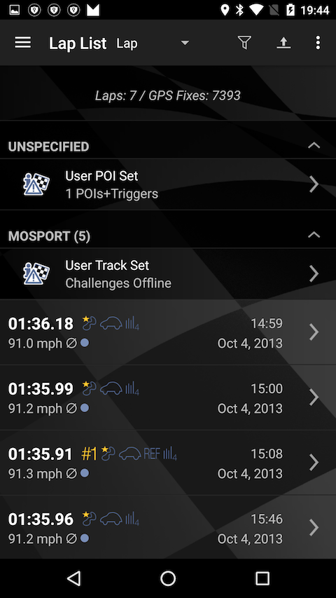

Here is the certification process once you have defined a set of POIs (sample Mosport):
This is the Lap List showing a the track Mosport, and user defined track set. Selecting the row User Track Set brings you to the POI Set View:

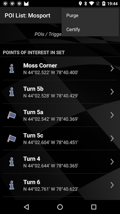

Select the options menu in the top right and select Certify...
To come to the QA dialog. All stars yellow, so the track is ready to be submitted using Certify (which in turn generates a mail).
