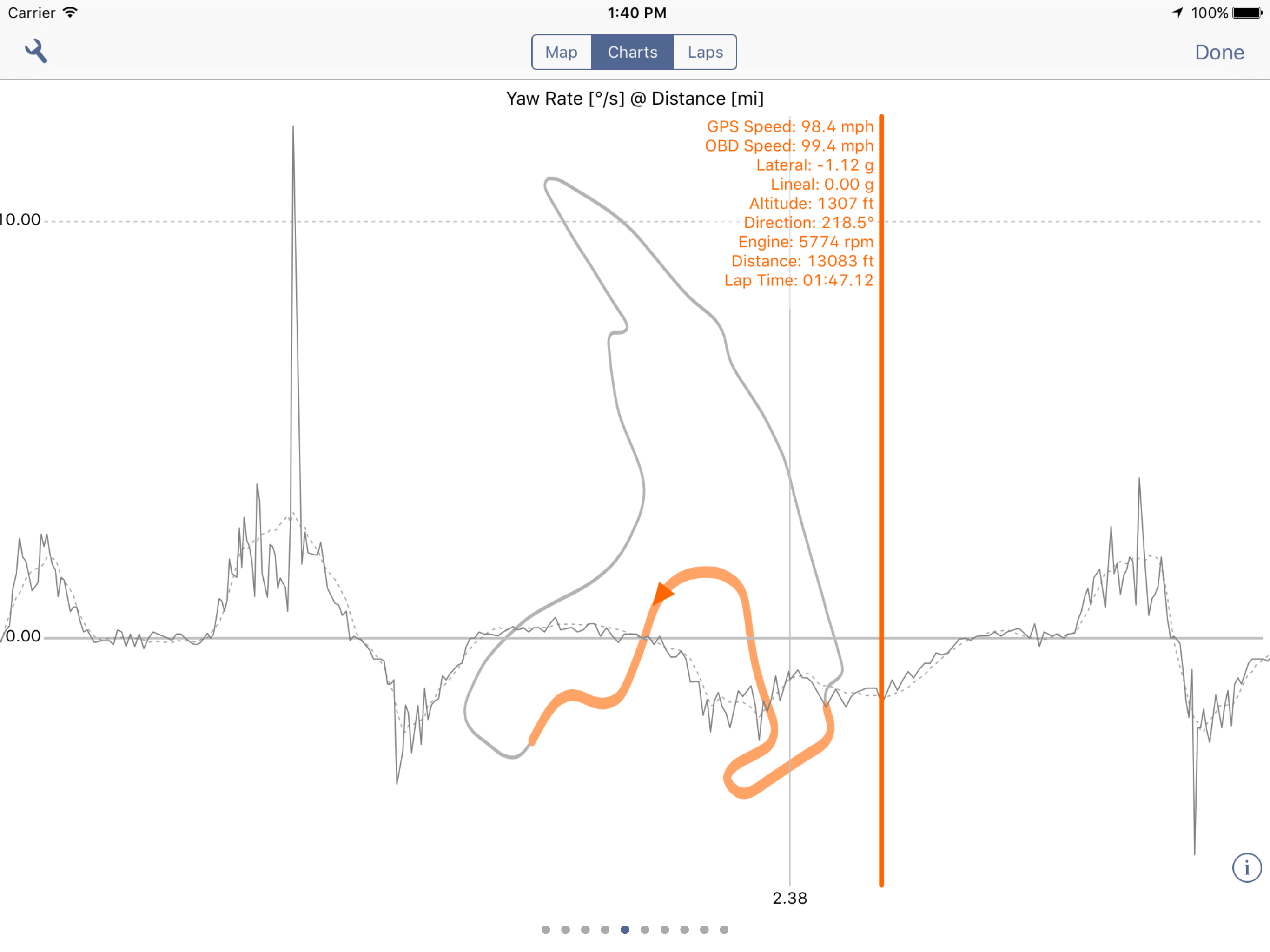

I did some experiments with yaw calculation and the results from (measured) acceleration based yaw rate is indeed a lot smoother than the one deriving it from direction changes (click the picture, this should give you a iPad Pro resolution):
Acceleration based yaw rate is dotted, the old one is solid. In the snapshot shown averaging has been disabled for both.
Data shown is a recording sampled at 4 Hz.

That looks like it doesn't need further smoothing.
Re: Yaw Rate Chart
Well - it is smoothed already during acceleration smoothing. But yes, I do not see further smoothing is necessary.
When using calculated acceleration, results are exactly like the former data.

The acceleration smoothing was what I thought might be a problem. Was that data acquired with accelerometer update at 30Hz? If so, that looks like is isn't causing a reduction in peak yaw rate and peak shift for race track data. I would still want to use the maximum rate for autocross. The yaw rates are a lot higher, up to 60degrees/second,or so.
