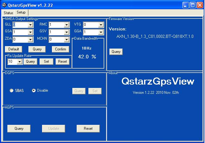

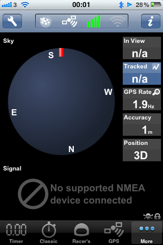

when im using myQstars 818XT 10hz device im getting the message from harry that No NMEA Device connected.
Are there anything in the Qstar Program i can change to get it connected ?
please see the attached pictures.
Are there anything else i should change in the Qstars program to make anything better as i have no idea about what GLL,GSA, ZDA, RMC, GSV, MCHN, VTG, GGa is i can change everything from 0 to 5.
No supported NMEA Device connected.

Re: No supported NMEA Device connected.
LapTimer supports two types of accessing GPS sensors: 1) Using Apple's location manager and 2) accessing the device directly.
Only devices accessed directly (#2) make their NMEA stream available. Only for these devices, the Satellites View will be functional. Namely the TomTom car kit and the G-Fi have this support.
All devices hooking into Apple's location manager are in category #1. To connect an arbitrary GPS device, you need to jailbreak your phone and connect the mouse using BTStack GPS, a little program available from Cydia. For device configuration, please contact the author of Cydia. BTStacks replaces Apple's location manager and operates like the internal sensor. LapTimer will not be able to see the difference (although it can process the higher update rates delivered).

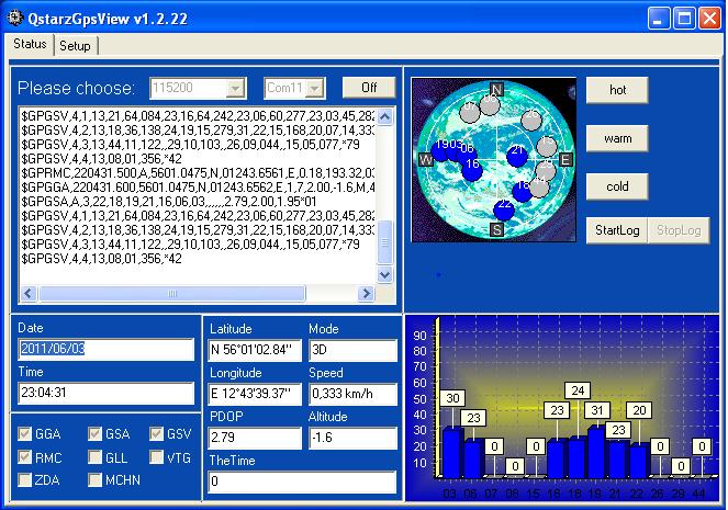

If you look at the pictures can you see anything that i can change to make something better or faster ? like the GLL,GSA, ZDA, RMC, GSV, MCHN, VTG, GGA
Or do you know a webpage where i can see what all this GLL,GSA, ZDA, RMC, GSV, MCHN, VTG, GGA is

there is some general recommendation from the PalmOS times. I'd assume it is applicable to the iPhone / BTStack configuration too:
- Harry... most receivers come with tools to reduce the types and frequency certain GPS / NMEA sentences are sent. Please configure your GPS receiver to send RMC and GGA only with high frequency (e. g. 4Hz) and in addition GSA and GSV with low frequency (e. g. 1Hz). Everything else is ignored by LapTimer anyway…
