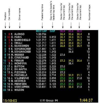

The second part to my question is itself in two parts, the second have of which I believe has been mildly discussed before, it is in regards to viewing this data to a more detailed extent live from the pit lane. I have looked at the online page in both the Pro version and the Trainer version as we are using both, but I do not see a way to see the individual sector times or any further detail other then position and previous lap times. Now to the other half of the question, is there a way to view the data directly on or out of the server easily in a classic leader board style view (something along the lines shown from F1 below)?
F1 Live Timing Qualifying Screen

On the data exchanged: it is pretty limited today (documented on the Online page) and mainly made up from position information (shown in the Online view), and a full lap time hall of fame (shown in Online view - 10 only, and shown in the Add-ons (by track) limited to 500 lap times). Finally, there is an exchange of Alerts (yellow flags). There is no exchange of telemetry, sector times etc.

In terms of what is sent to the server and server load, I am assuming looking at the trace when I was able to get it, that the broadcast frequency is between 0.5-1.0Hz? Also, if I understand you correctly, there are three pieces of data that get included in the broadcast data bundle at its densest, position in I assume decimal lat and long, previous lap time in the first bundle after the stop/start trigger and whether or not an Alert has been triggered. If I am thinking this all out correctly, would it really increase server load by any significant margin to include in the bundle the sector ID and time immediately after an intermediate trigger? Perhaps putting a toggle in the expert setting menu to turn this feature on, with it's default position being off to keep server overhead down since most do not need it. Then if there is desire to create a live timing board at the end workstation that download's the data, all the basic information is there and all the actual logic needed to create a nice looking board can be taken care of at the final local-level. With this not necessarily having to be created by you, but perhaps a Harry's Laptimer enthusiast.
The reason I am kind of pushing for the sector times, is that this is kind of the essential for being able to actually use the data live in the pit for real-time support of the driver. It would provide the hobby track-day racer with something that no other entry to mid-level system out there has, since I am already finding that I am convincing guys just by showing your software to them into going your route over a $1000 dedicated unit. This capability could perhaps provide a potential marketing point to get this supported at the track-day organizer level, providing you with another possible cliental base. Something far better then an infrared lap timer system that has less hardware and potentially cost overhead for them to implement. While yes, I do agree that this is probably changing your business model a bit with the potential route it could take, I think it still is a good potential opportunity for your software. I hope my last points convey what is in my head properly, as I am not totally sure writing this at 3:41am. lol Let me know if it does not make sense!

Thanks Sean for your design. The communication between iPhone and the server in Cologne is working a bit different. Data size is minimized by sending every piece of data only once. The server caches everything and joins information from one client by using a (nearly) unique id. So it is very effective. It is not be a problem to add more data (e.g. intermediates), the question is more on the order I work on feature request :-) Will check this for v16. I believe a very important feature would be a web front end to have a more universal front end in the pits?
