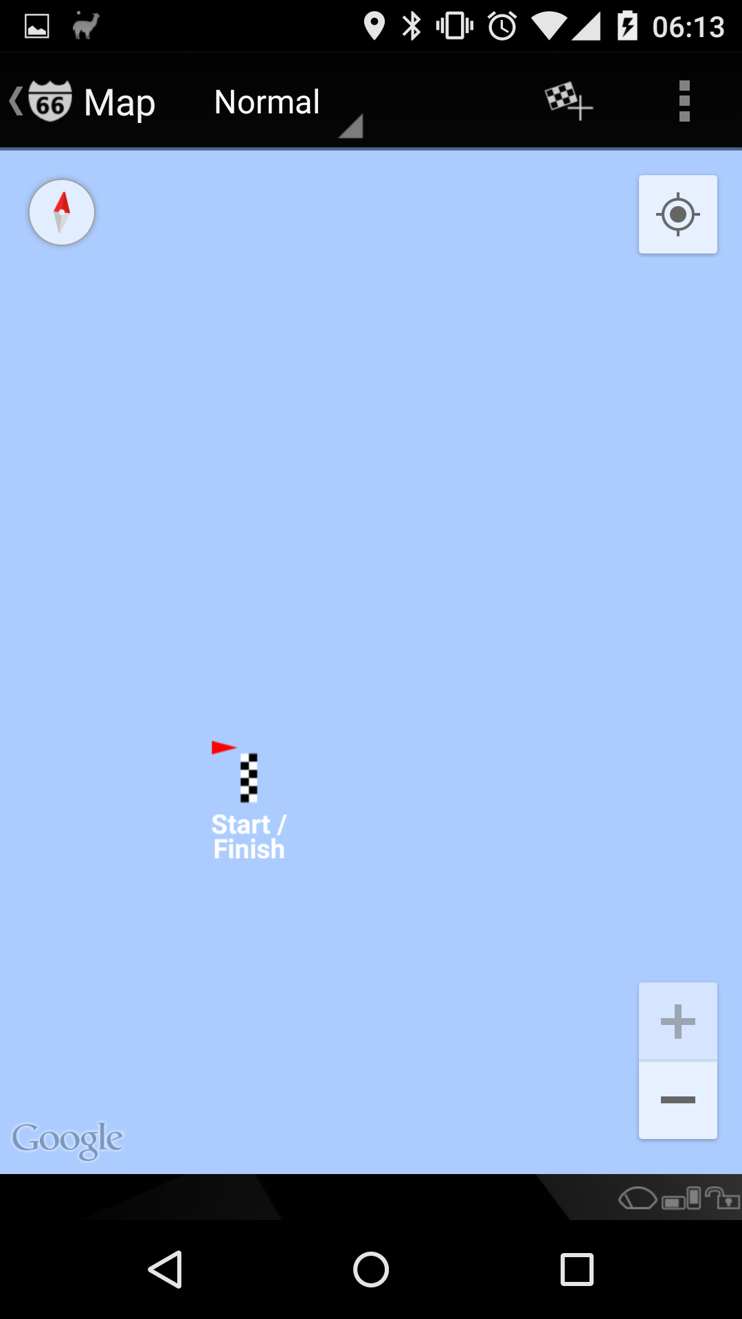

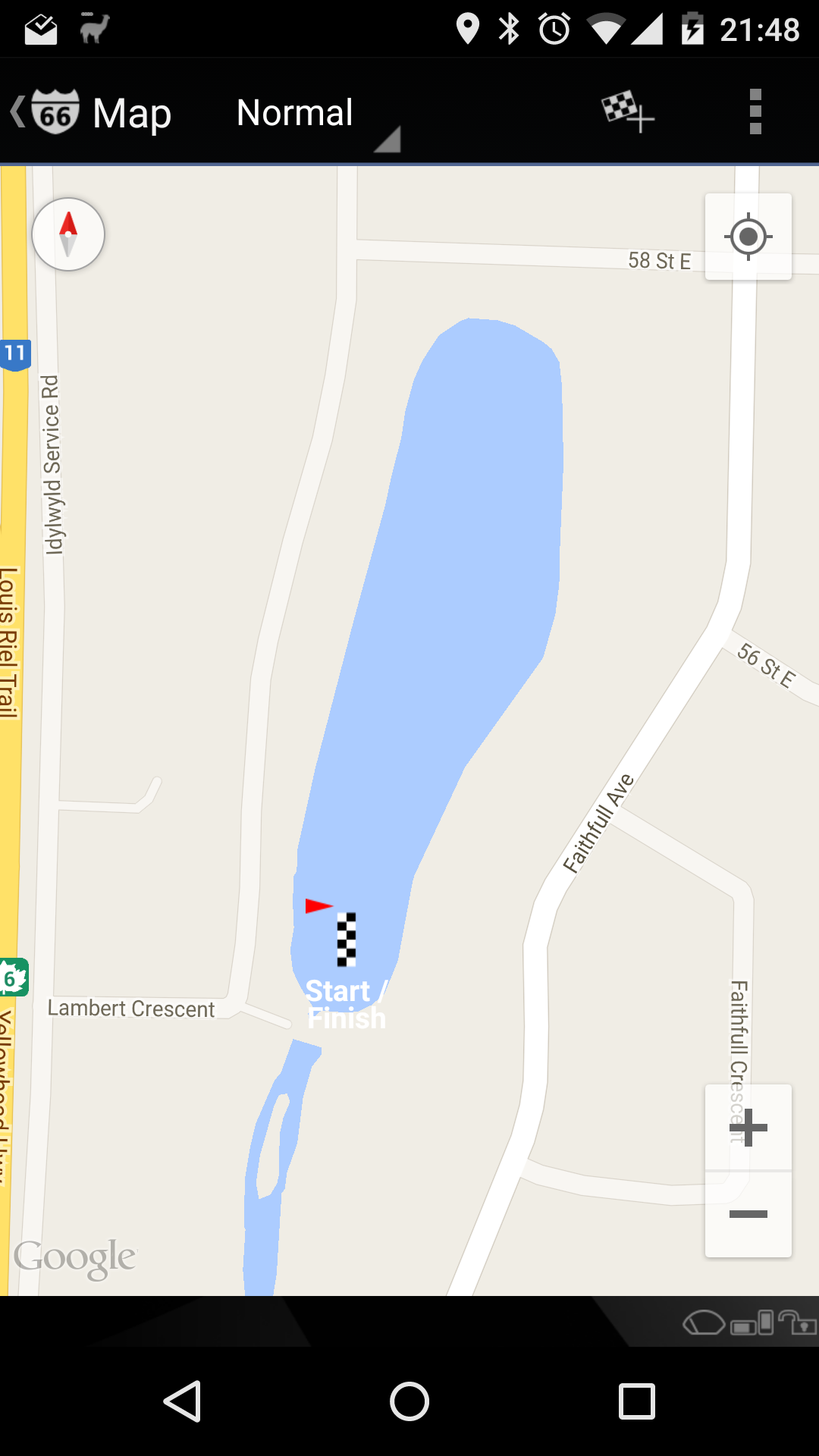

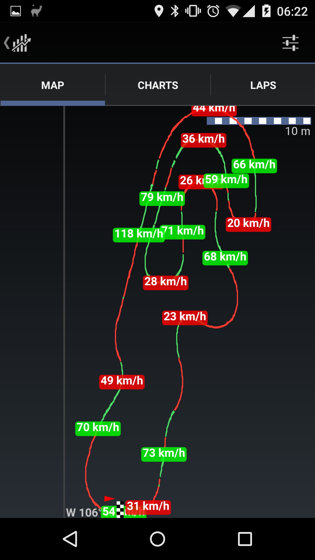

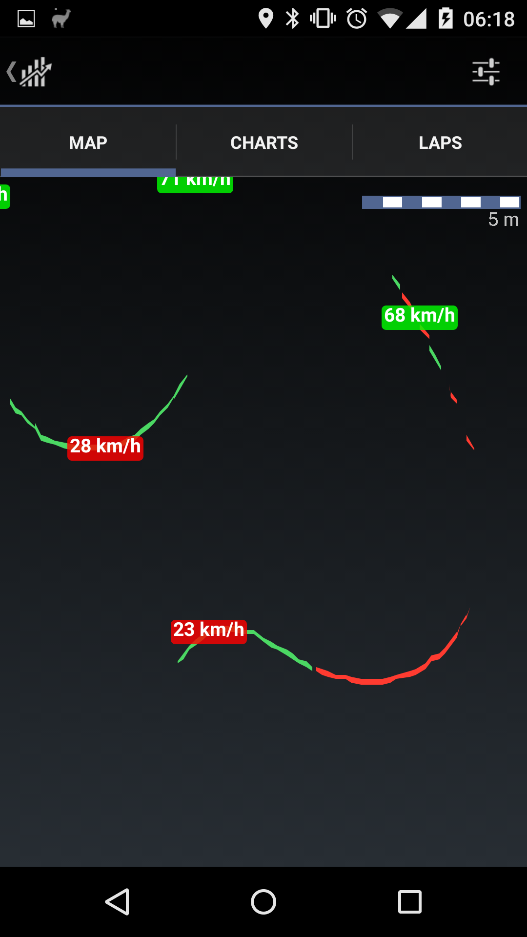

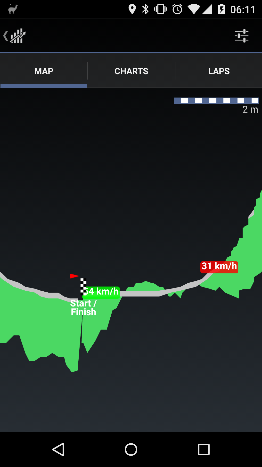

I have created a new track by setting the start/finish line, and raced a few laps on it. It records my lap data and everything, but when I go into the POI List for the map and go into the map screen the only thing that shows up is the start/finish. I was expecting to side the track outline. Is it normal not to see the track outline?

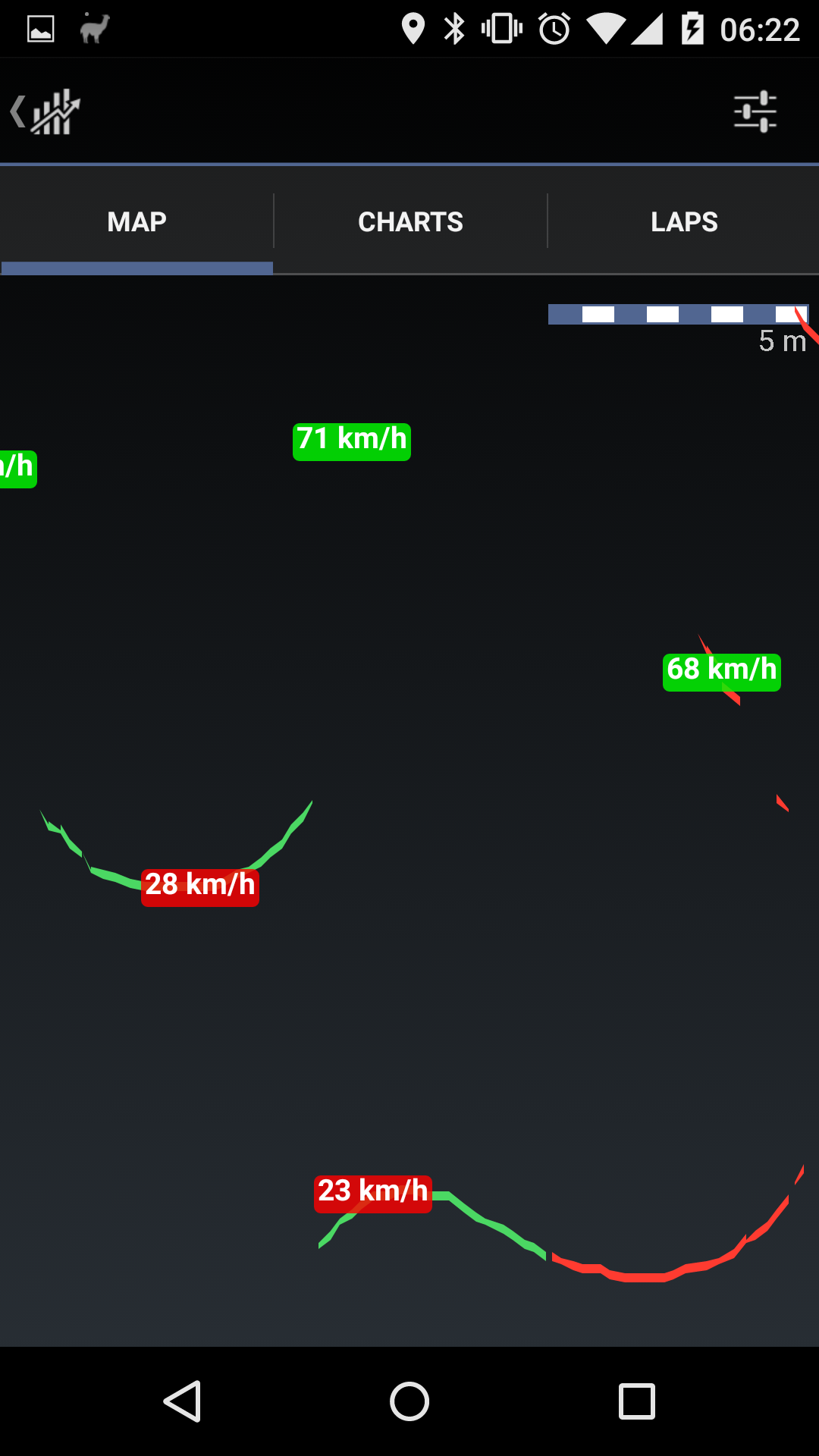

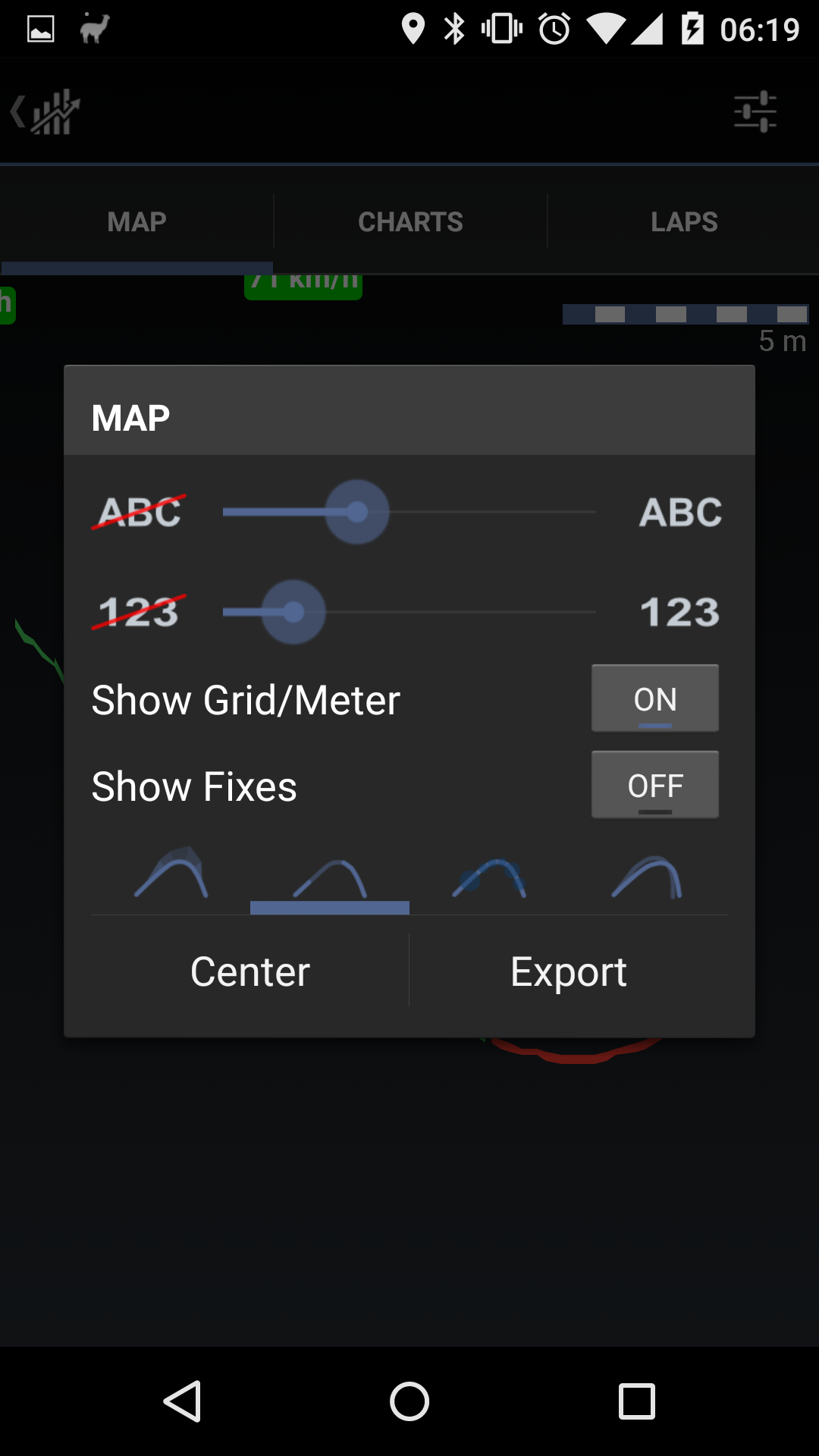

For the Map graph, please zoom in to reveal details. As an alternative, select the option button in the top right and increase then visibility threshold for labels.
The map view (second snapshot) should actually show all the labels but has some intermittent update issues. Please try to change the zoom level here too and let me know if the POIs appear.

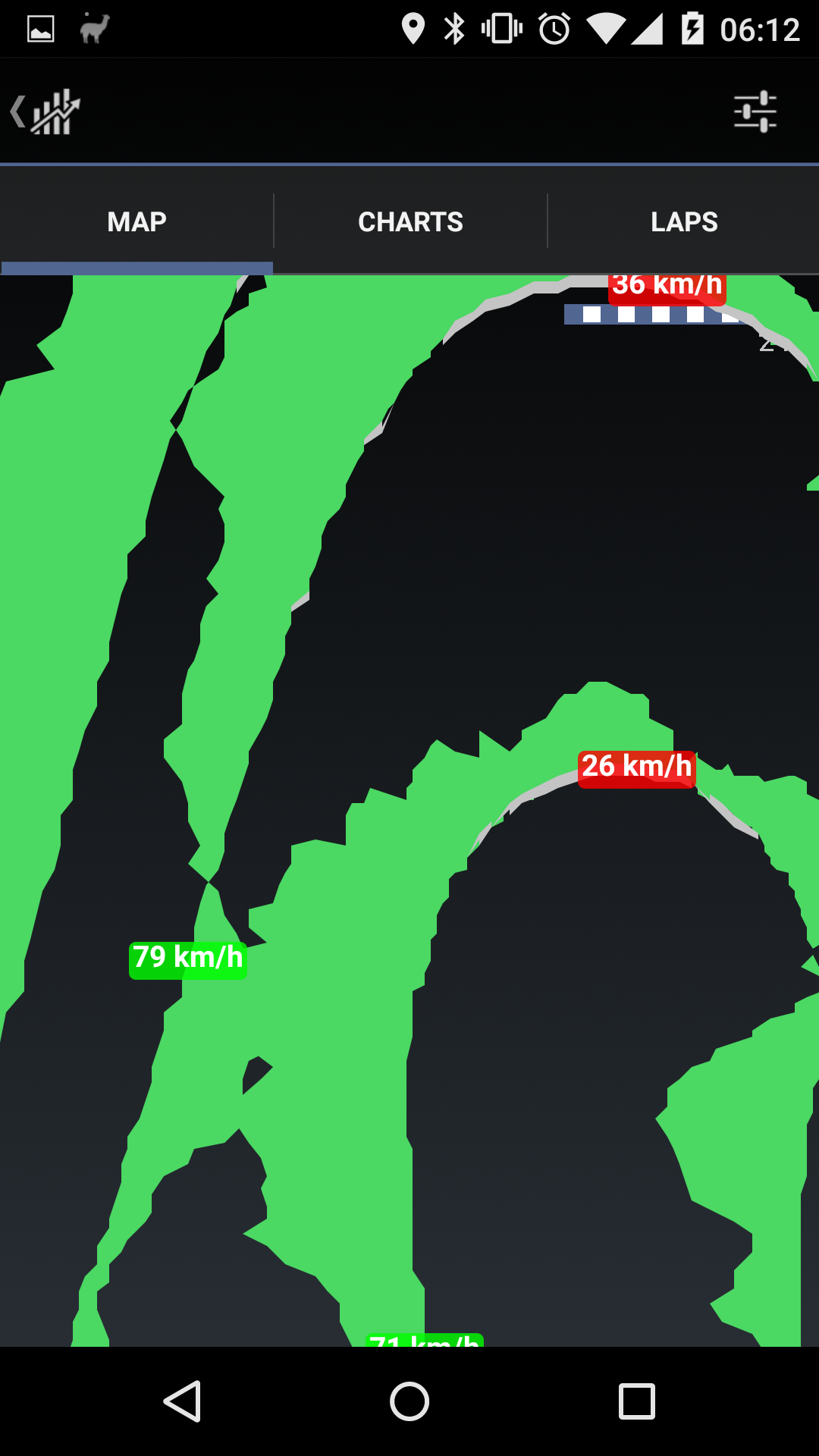

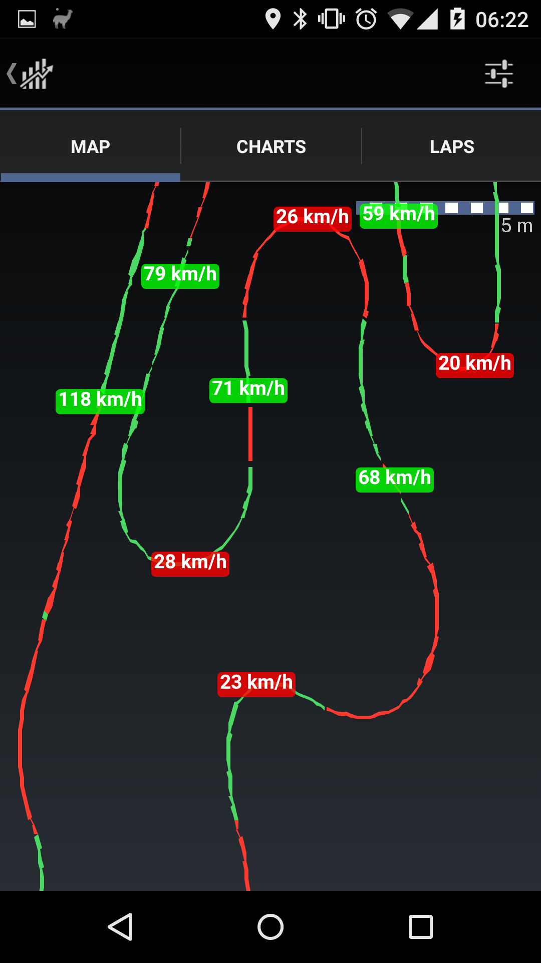

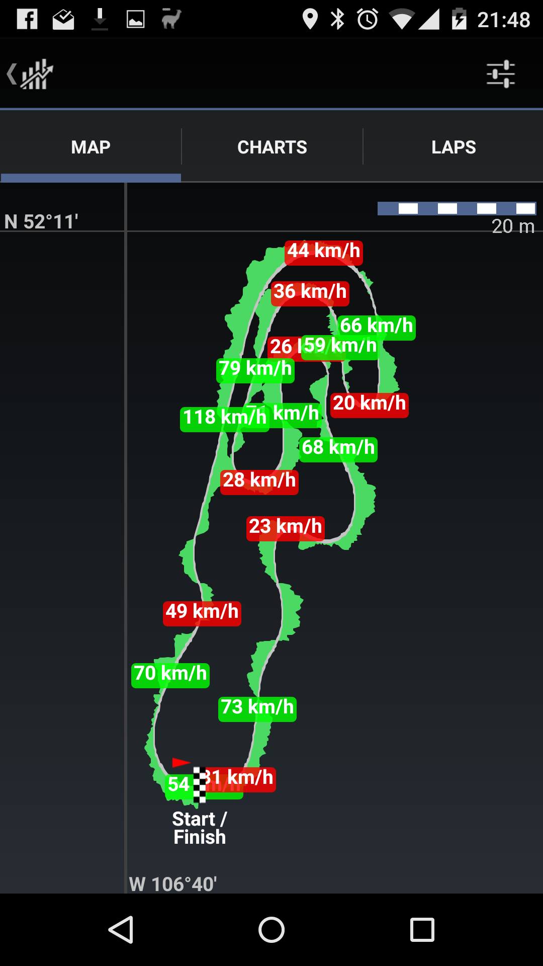

It doesn't matter what zoom level the only thing I see in map view is the start/finish line. I also noticed that when I zoom in on the map graph some of the track outline disappears. And when I change some of the view settings it seems like some of the data is hidden underneath the map.

More screenshots

some more screenshots

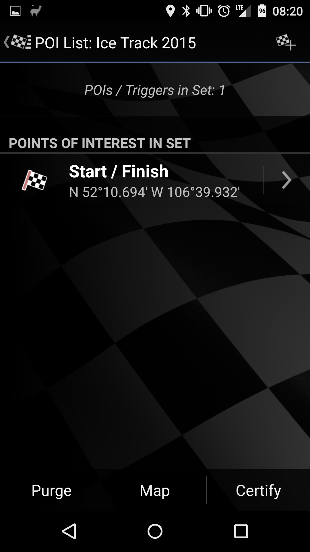

Can you please post a snapshot of your track's POIs? It is available from Lap List -> first row of track section showing something like "User Track Set"...

But this is only a Start / Finish trigger? Are the other POIs in a different track set?
Re: Question about creating a new track
It's only showing Start/Finish because that's the only POI you created. If you want, say split points, you have to create them as well.
You can create splits after the fact and recalculate.
